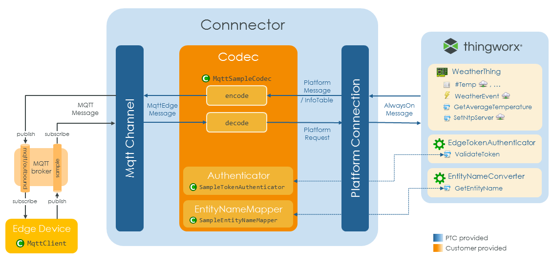

MQTT Connector features
The MQTT Sample project provides a Codec implementation that service MQTT requests and a command line MQTT client to test the Connector.
  • The sample MQTT Codec handles Edge initiated requests
    • read a property from the ThingWorx Platform
    • write a property to the ThingWorx Platform
    • execute a service on the ThingWorx Platform
    • send an event to the ThingWorx Platform (also uses a ServiceEntityNameMapper to map an edgeId to an entityName)
All these actions require a security token that will be validated by a Platform service via a InvokeServiceAuthenticator.
  • This Codec also handles Platform initiated requests (egress message)
    • write a property to the Edge device
    • execute a service without response on the Edge device

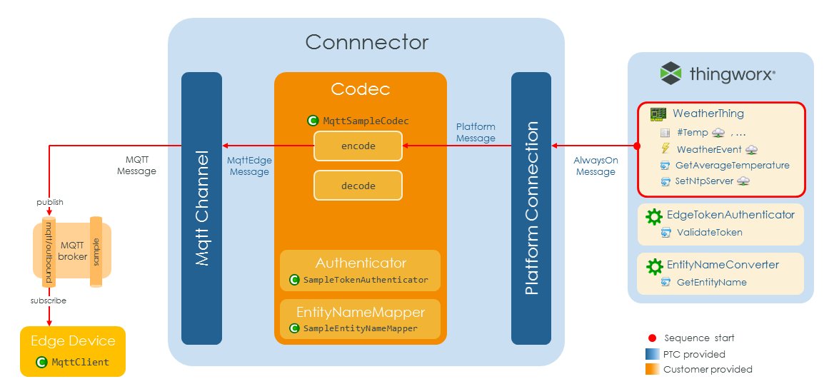

 Components and Terminology
  • Mqtt Messages originated from the Edge Device (inbound) are published to the sample MQTT topic
  • Mqtt Messages originated from the Connector (outbound) are published to the mqtt/outbound MQTT topic

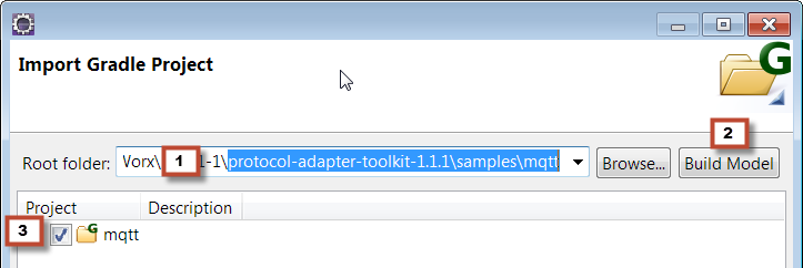

  • Import the MQTT Project :
    • File > Import > Gradle (STS) > Gradle (STS) Project
    • Browser to <protocol-adapter-toolkit>\samples\mqtt, then [Build Model] and select the mqtt project

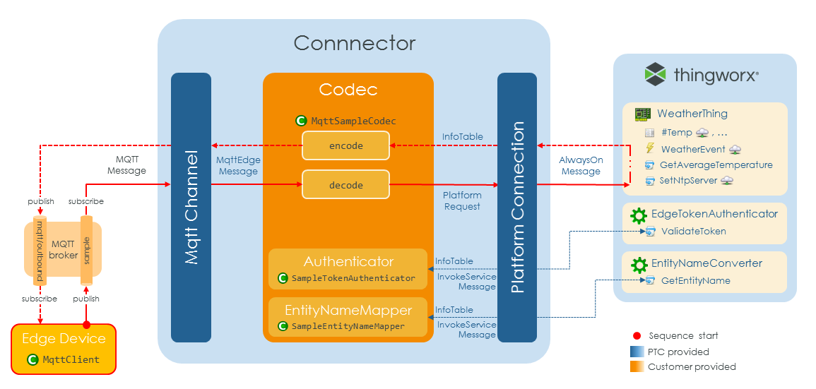

 Test Edge initiated requests
Read a property from the ThingWorx Platform
  • In the MQTT client console enter : readProperty WeatherThing temp
Sending message: {"propertyName":"temp","requestId":1,"authToken":"token1234","action":"readProperty","deviceId":"WeatherThing"} to topic: sample
Received message: {"temp":56.3,"requestId":1} from topic: mqtt/outbound

Write a property to the Edge device
  • The MQTT Connector must be configured to bind the Thing with the Platform when the first message is received for the Thing.
    • This was done by setting the bind-on-first-communication=true in connector.conf
    • When a Thing is bound, the remote egress messages will be forwarded to the Connector
    • The Edge initiated requests above should have done the binding, but if the Connector was restarted since, just bind again with : readProperty WeatherThing isConnected
  • From the ThingWorx composer update the temp property value on WeatherThing to 30
  • An egress message is logged in the MQTT client console :
Received message: {"egressMessages":[{"propertyName":"temp","propertyValue":30,"type":"PROPERTY"}]} from topic: mqtt/outbound
