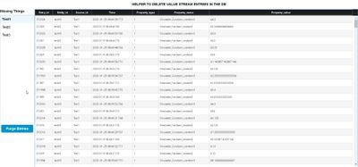

Currently, I was asked this question and wanted to share this with the entire community. I created a utility application that queries directly the TWX DB for Things that are present in the ValueStream but don't exist anymore and allows a user to purge it.
These services are considering  PostgreSQLServer as persistence provider for the ValueStreams. The services can be modified if you're using SQLServer.  Do not apply for InfluxDB persistence providers

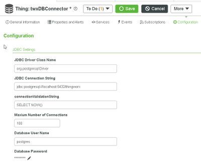

The twxDBConnector thing is based on the PostgreSqlServer template, that is present in the Relational Databases extension. It has 4  main services:
getEntriesToPurge:  Queries the TWX DB for all the entries related to a Thing. It does not consider the ValueStream id, so it will purge all the entries across all value streams. Requires a Thing name as an input;
getMissingThings: Queries Things that are present in the ValueStream DB table that are not present in the Things table, meaning that they were deleted;
purgeThingEntries: Purges the entries related to a Thing. It does not consider the ValueStream id, so it will purge all the entries across all value streams;
purgeAllEntries: Purge all the entries related to Things that were deleted.
The queries can be modified to allow the selection of the value stream to be cleaned.
I also added a sample mashup that leverages the services.
The twxDBConnector has a configuration table that requires the DB Connection string, user and password.

Attention: These services are changing directly the TWX DB, so use it carefully.
To use it:
  1. Import the PostgresSQLServer Extension (you might need to change the JAR in the extension depending on the TWX version you're using);
  2. Import the entities from the purgeVSEntries.xml
