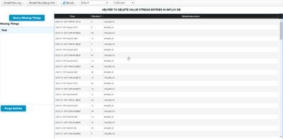

While I was writing my previous post about Purging ValueStream entries from Deleted Things , it occurred to me that a similar issue would happen to those using the InfluxDB as persistence provider for their ValueStreams.
I wanted to take the opportunity that the logic is still fresh in my mind and extend the utility to do the same thing with InfluxDB. I also used the opportunity to create a dynamic InfoTable as it's been a while since I did it.
Also, it shows how to directly interact with the InfluxDB through its API.
The modification is based on a new thing called influxDBConnector  which has the following services:
dropMeasurements: Deletes all the DB entries related to a Thing;
getAllEntries: Queries all entries related to a Thing. It has a string output;
getAllEntriesTable: Queries all entries related to a Thing. Infotable output;
getMissingThings: Queries ThingWorx Things tables and InfluxDB measurements. It filters to have in the result only the Measurements that are not in the Things table;
showMeasurements; Gets all the measurements in InfluxDB
Also the following properties:
database: Influx database name used to persist the value stream data;
InfluxLink: hostname:port to the InfluxDB server
Like the previous example, I created a sample mashup (purgeInfluxDBStreamsMashup ) to help to execute the services:
Obviously this utility expects that there's an existing Influx persistence provider.
Once more: these services affect directly the DB and need to be used carefully and only by Administrators.  Make sure you fully test it before using it in production.
