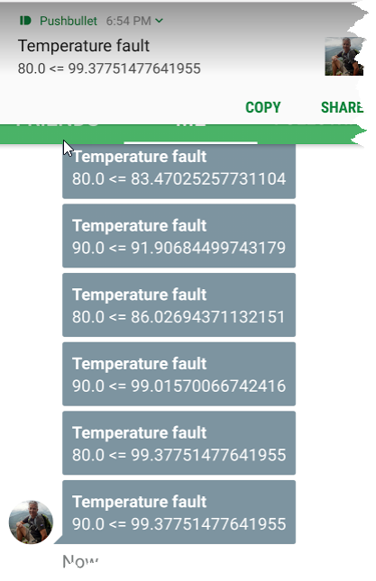

Pushbullet is a lightweight notifications platform and can be a way to explore Alerts and Subscriptions

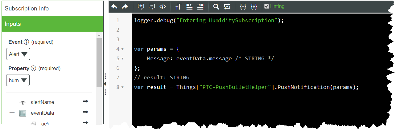

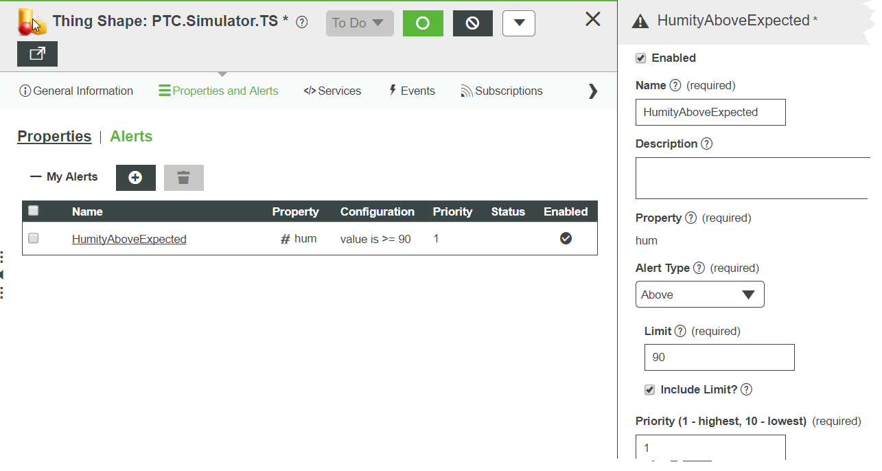

Basically create an an Alert on a property and Subscribe to that Alert
Adding Alert to Property Humidity
Adding Subscription

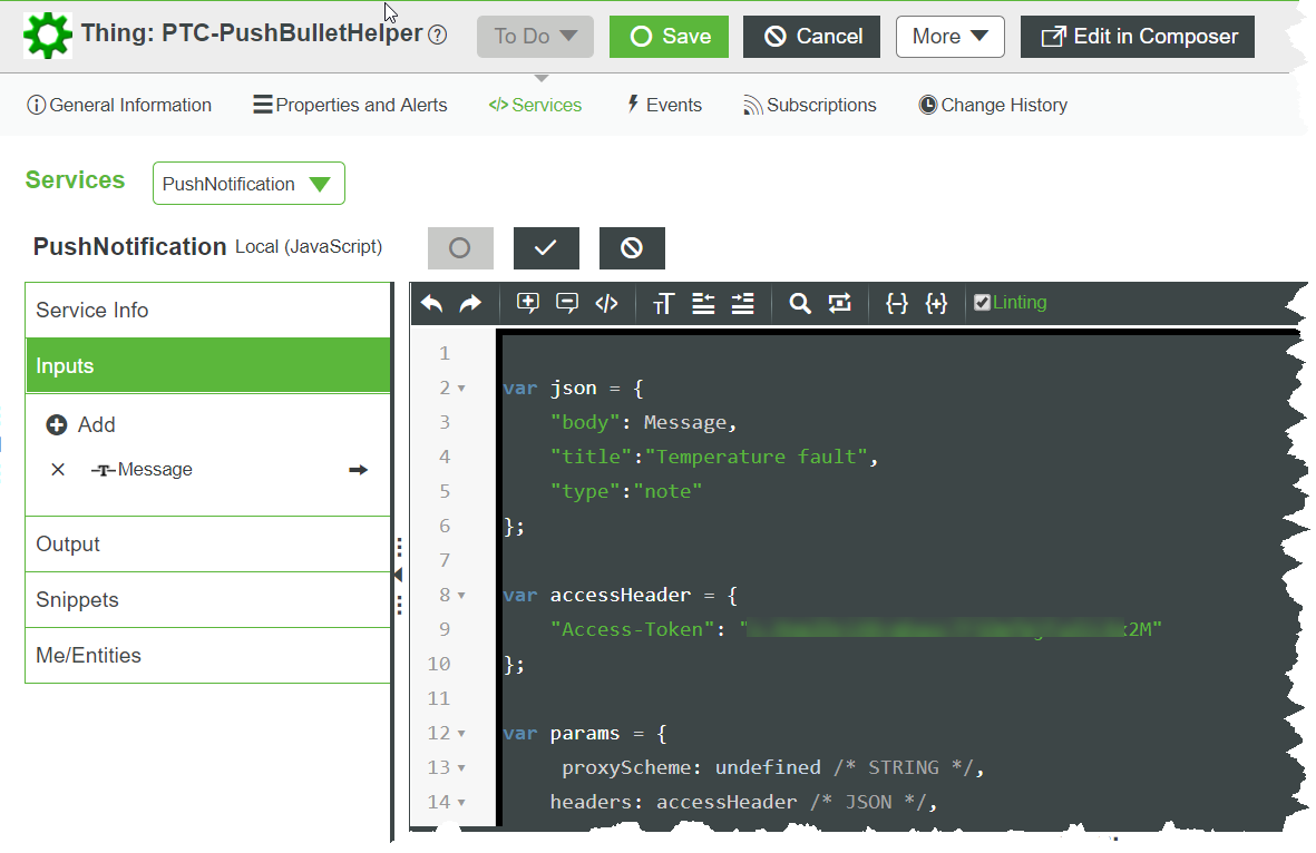

The PTC-PushBulletHelper is just a generic Thing with a service called PushNotification
var json = {
    "body": Message,
    "title":"Temperature fault",
    "type":"note"
var accessHeader = {
    "Access-Token": "o.Hnm2DeiABcmbwuc7FSDmfWjfadiLXx2M"
var params = {
     proxyScheme: undefined /* STRING */,
    headers: accessHeader /* JSON */,
     ignoreSSLErrors: undefined /* BOOLEAN */,
     useNTLM: undefined /* BOOLEAN */,
     workstation: undefined /* STRING */,
     useProxy: undefined /* BOOLEAN */,
     withCookies: undefined /* BOOLEAN */,
     proxyHost: undefined /* STRING */,
     url: 'https://api.pushbullet.com/v2/pushes' /* STRING */,
     content: json /* JSON */,
     timeout: undefined /* NUMBER */,
     proxyPort: undefined /* INTEGER */,
     password: undefined /* STRING */,
     domain: undefined /* STRING */,
     username: undefined /* STRING */
// result: JSON
var result = Resources["ContentLoaderFunctions"].PostJSON(params);

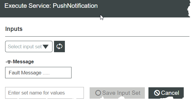

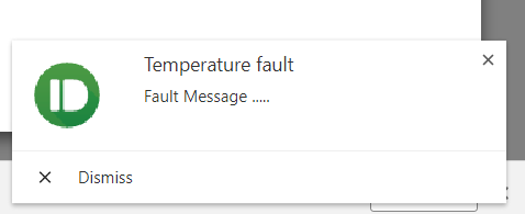

You can test the Helper PushNotification service

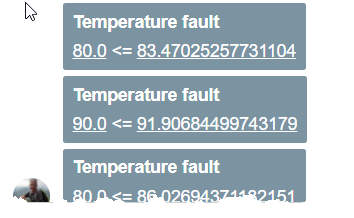

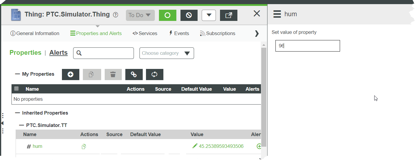

Next you can test the subscription
