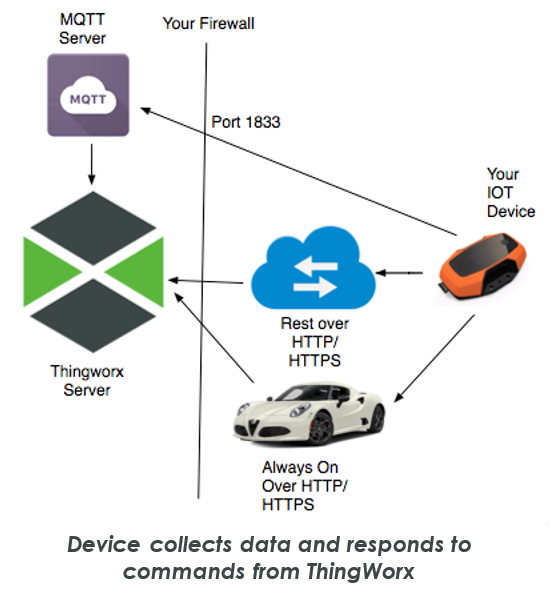

Kaya: At a high level, why do SDKs leverage AlwaysON?
Shravan: Typically, transferring data to a server in IoT would require leveraging either REST web services, which has high connection overhead, works over HTTP or using MQTT, which requires a server and additional open ports.
So, an ideal connection should have three key features as a minimum:
  1. Stays continuously on.
  2. Is always ready to receive data and execute commands.
  3. Should also use existing open ports on firewall.
ThingWorx Edge SDKs provide this ideal connection though “Always On” protocol, which is based on WebSockets.

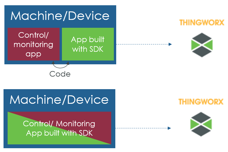

Kaya: How can you deploy SDK-based agents to devices?
Shravan: You can deploy the agent in two main ways. One where the agent lives adjacent to the control and monitoring application of the machine and the other where the agent is directly integrated to the control and monitoring app of the machine.image
