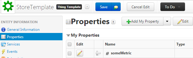

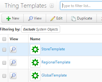

First, create a template for each of your hierarchical levels. In my case it is a GlobalTemplate, RegionalTemplate, and StoreTemplate. Add a property to your StoreTemplate that will be the KPI.

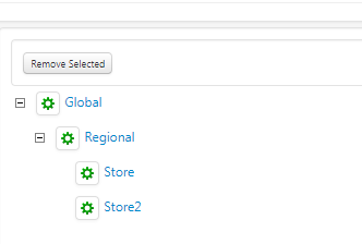

Now, create a Thing for the Globe, and each of your Regions and Stores. Add them to a hierachical Network as such:
