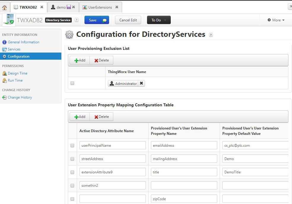

With the above configuration once the Active Directory entity is successfully created under the ThingWorx Composer > Security > Directory Services, navigate to it and scroll down to the section named User Extension Property Mapping Configuration Table
imageConfiguration for Directory Service

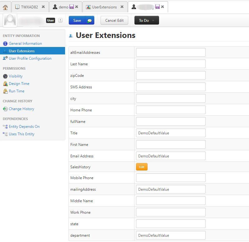

Once the Active Directory entity is successfully created and connected to the target Active Directory, all the users that now gets provisioned from Active Directory within ThingWorx will get their attributes filled up automatically, given that the mapping is correct and the value actually exists in Active Directory for those mapped attributes, something like this
PS: Attributes not mapped will be left blank in the user's user extension properties
Auto populating of entities will also happen even after the user has been created on first login. Meaning if there are further AD attributes which are mapped with the user's user extension properties, value for them will also be pulled on next login done by the user there is no need for ThingWorx restart here.
As shown in the screenshot above for section User Extension Property Mapping Configuration Table, these values can be added or deleted.
