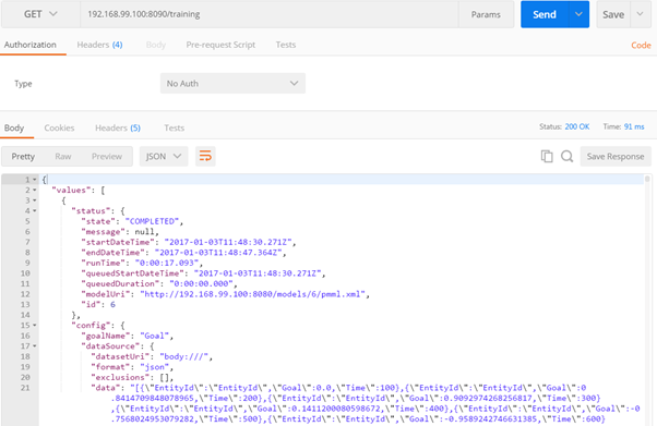

In order to validate the successful creation of a training job, execute a GET request to the training micro service : http://192.168.99.100:8090/training (update the ip address to the one on your system)
This should return a COMPLETED job whose body starts with something similar to:

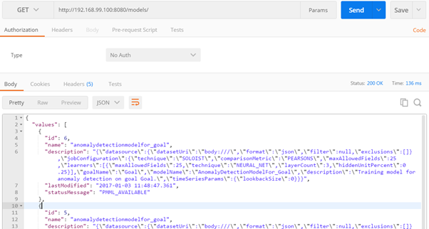

In order to validate the successful creation of a model job, execute a GET request to http://192.168.99.100:8080/models (update the ip address to the one on your system) to see all the models that have been created. For example:

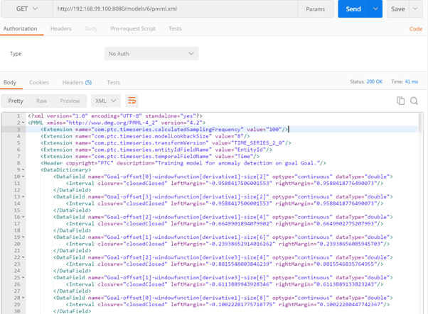

Alternatively, click (or use) the URI reported in the training job output, here http://192.168.99.100:8080/models/6/pmml.xml, to see the complete model definition. The output will be similar to:

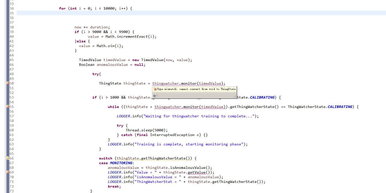

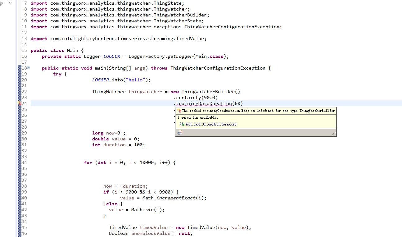

Hi Christophe
I set the Thingwatcher according to the above guide, edit trainingBaseUrl and run the java utility(main.java) to run Training.
My code error like picture .
cmorfin19-TanzaniteAuthor
Hi
What version are you using ?
The main.java was created with 52.2 version of ThingWatcher - I think it woudl work up to version 7.4.
For version 8.0, you would need to check the chapter Update for ThingWorx Analytics 8.0 in the blog
Hope this helps
Christophe
Hi Christophe
I see  , I using version 8.0,   thanks.
