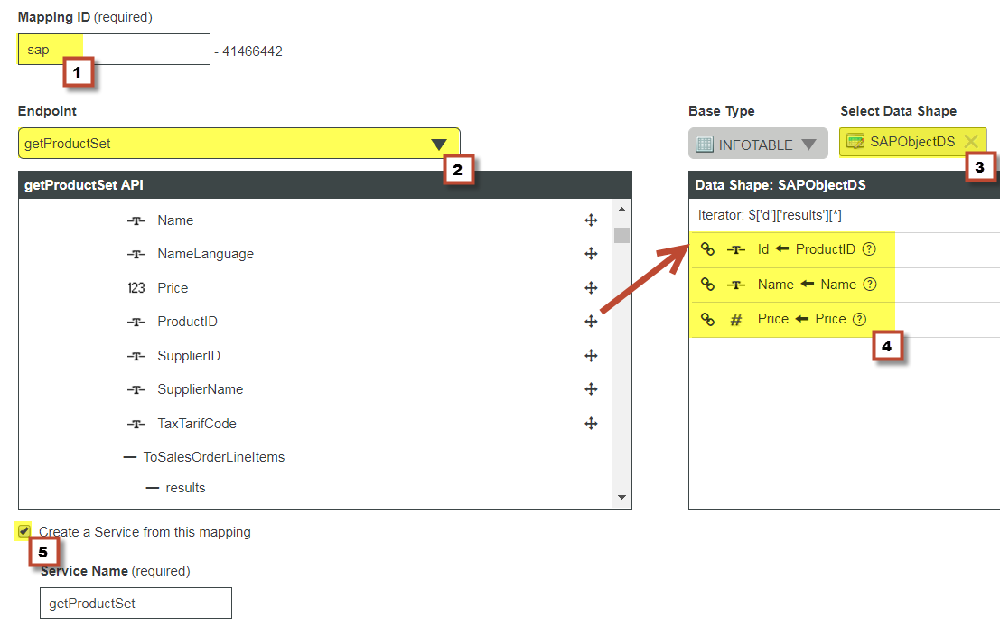

4. Create the API maps and service under TestSAPConnector > API Maps (New Composer only)
    • Mapping ID : sap
    • EndPoint : getProductSet
    • Select DataShape : SAPObjectDS (created at step 1) and map the following attributes :
      • Name <- Name
      • Id <- ProductID
      • Price <- Price
    • Pick "Create a Service from this mapping"

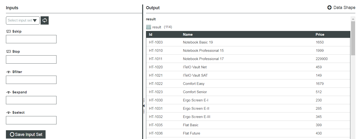

Testing our Connector
Test the TestSAPConnector::getProductSet service (keep all the input parameters blank)
