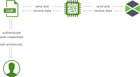

The Edge Micro Server (EMS) and the LUA Scripting Resource (LSR) allow for an easy connection of sensors and / or data to the ThingWorx Platform.
Connections are usually established through the HTTP protocol and a REST API which sends unencrypted data and user specific credentials or ThingWorx application keys. This could be fine for a non-production environment. However in a more secure environment or in production, encryption and authentication should be used wherever and whenever possible to ensure the safety and integrity of the data.
In this scenario a user, client machine or remote device can utilize the LUA endpoints via the REST APIs endpoints.
For this an authentication mechanism with credentials is required to only allow authenticated sessions. Invokation of services etc. are all protected and encrypted via HTTPS. A default HTTP connection would transfer the credentials as clear text which is most likely not desired.
The LSR then communicates via HTTPS to the EMS.
The EMS communicates to the ThingWorx platform via the AlwaysOn protocol using an encrypted websocket on the platform side.

All connections going from the LSR to the EMS are defined in the config.lua with the rap_ parameters.
To setup a secure connection to the EMS, we need to provide the server as defined in the config.json in the http_server section (e.g. the default localhost:8000). Define the usage of SSL / TLS as well as the certificate file.
Client to LSR connection
All connection going to the LSR from any client are defined in the config_lua witht the script_resource_ parameters.
To ensure that all requests are done via authenticated users, setup a userid and password.
Configure the usage of SSL / TLS to encrypt the connection between clients and the LSR.
A custom certificate is not necessarily required - the LSR provideds its own custom certificate by default.
Now opening https://localhost:8001 (default port for the LSR) in a browser will open an encrypted channel forcing authentication via the credentials defined above.
Of course this needs to be considered for other calls implementing e.g. a GET request to the LSR.
This GET request also needs to provide the credentials in its header.
Authentication
It's recommended to also configure the LSR for using a credential based authentication mechanism.
When setting up the LSR to only accept incoming requests with credentials in the header, the script_resource_userid and script_resource_password can be used for authentication.
When connecting to an EMS using authentication, the rap_userid and rap_password can be used to authenticate with the credentials configured in the config.json
