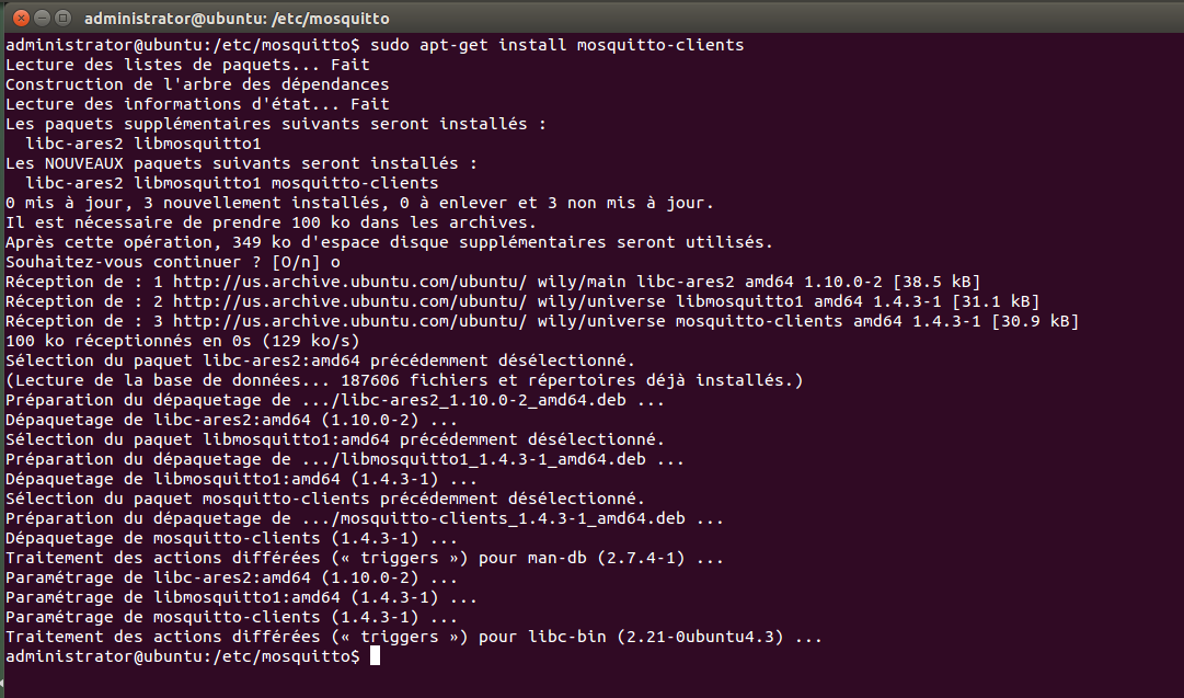

Demonstrations will be done with the open source MQTT broker, mosquitto. To install, use the apt-get command:
$ sudo apt-get install mosquitto
$ sudo apt-get install mosquitto-clients

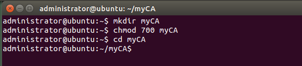

1. Setup a protected workspace
Warning: the keys for the certificates are not protected with a password.
Create and use a directory that does not grant access to other users.
$ mkdir myCA
$ chmod 700 myCA
$ cd myCA

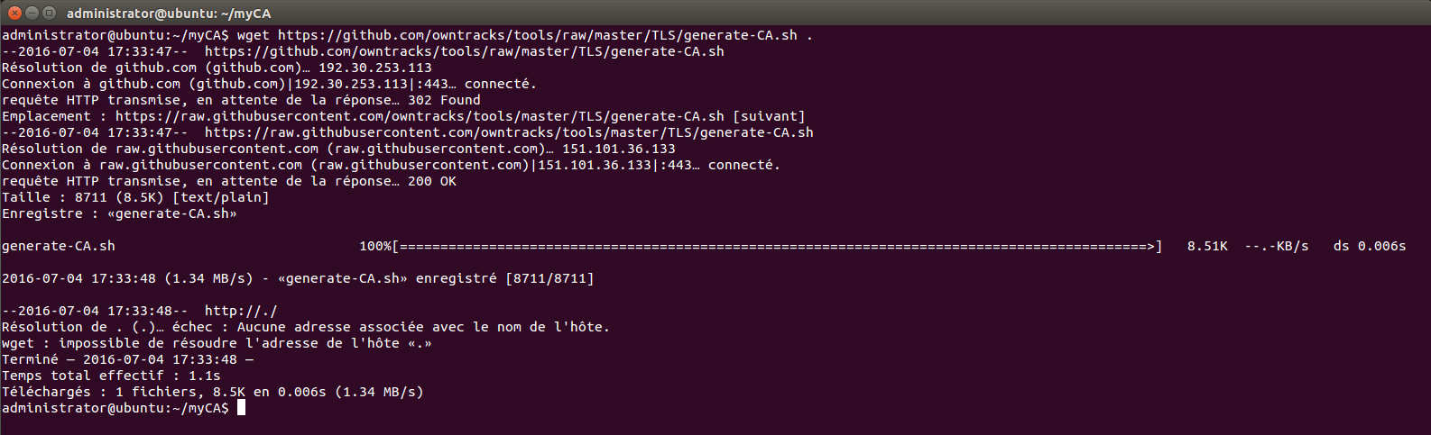

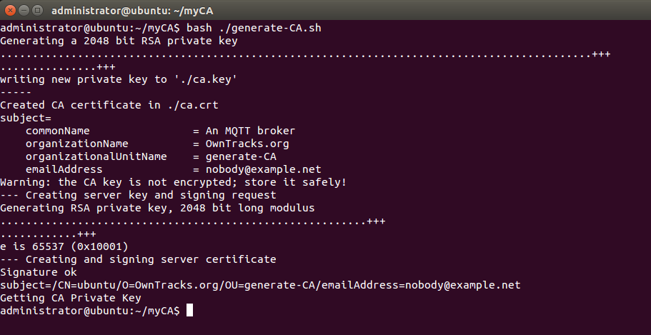

2. Setup a CA and generate the server certificates

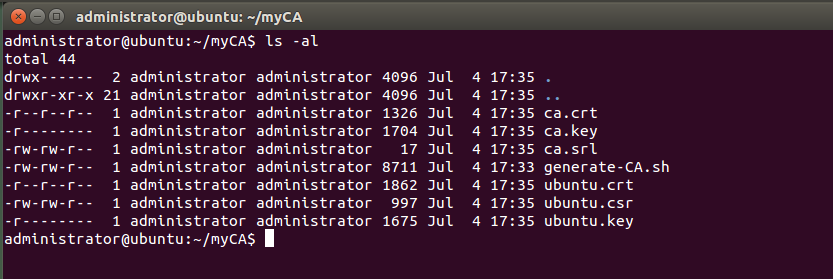

Download and run the generate-CA.sh script to create the certificate authority (CA) files, generate server certificates and use the CA to sign the certificates.
NOTE: Open the script to customize it at your convenience.
$ wget https://github.com/owntracks/tools/raw/master/TLS/generate-CA.sh .
$ bash ./generate-CA.sh
The script produces six files: ca.crt, ca.key, ca.srl, myhost.crt,  myhost.csr,  and myhost.key.
There are:
  • certificates (.crt),
  • keys (.key),
  • a request (.csr
  • a serial number record file (.slr) used in the signing process.
Note that the myhost files will have different names on your system (ubuntu in my case)

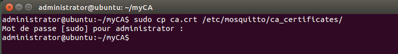

Three of them get copied to the /etc/mosquitto/ directories:
$ sudo cp ca.crt /etc/mosquitto/ca_certificates/
$ sudo cp myhost.crt myhost.key /etc/mosquitto/certs/

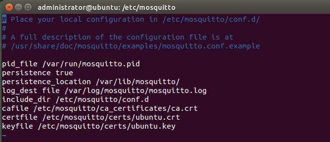

They are referenced in the /etc/mosquitto/mosquitto.conf file like this:

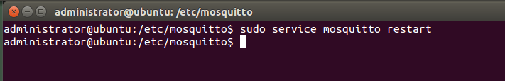

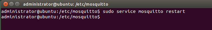

After copying the files and modifying the mosquitto.conf file, restart the server:
$ sudo service mosquitto restart

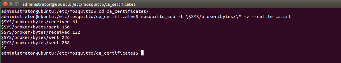

3. Checkpoint
To validate the setup at this point, use mosquitto_sub client:
If not already installed please install it:
Change folder to ca_certificates and run the command :
The topics are updated every 10 seconds. If debugging is needed you can add the -d flag to mosquitto_sub
and/or look at
/var/logs/mosquitto/mosquitto.log.

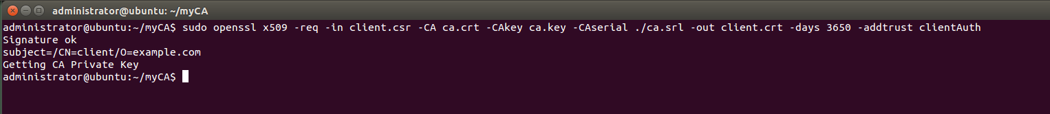

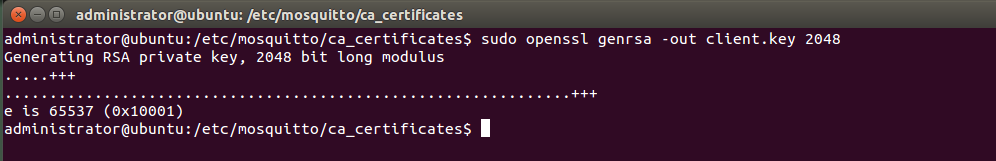

4. Generate client certificates
The following openssl commands would create the certificates:
$ openssl genrsa -out client.key 2048
$ openssl req -new -out client.csr  -key client.key -subj "/CN=client/O=example.com"
$ openssl x509 -req -in client.csr -CA ca.crt  -CAkey ca.key -CAserial ./ca.srl -out client.crt  -days 3650 -addtrust clientAuth
The argument -addtrust clientAuth makes the resulting signed certificate suitable for use with a client.

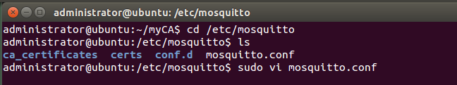

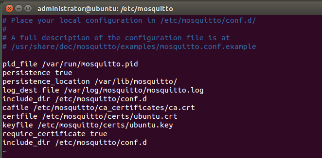

5. Reconfigure
Change the mosquitto configuration file
To add the require_certificate line to the end of the /etc/mosquitto/mosquitto.conf file so that it looks like this:
Restart the server:

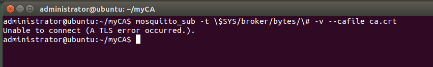

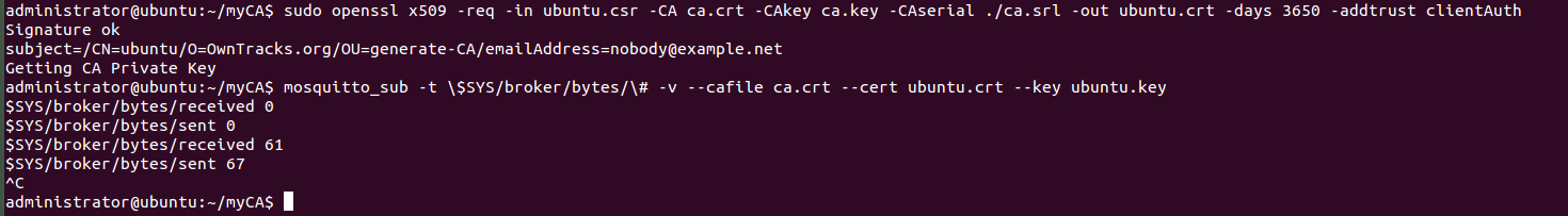

6. Test
The mosquitto_sub command we used above now fails:

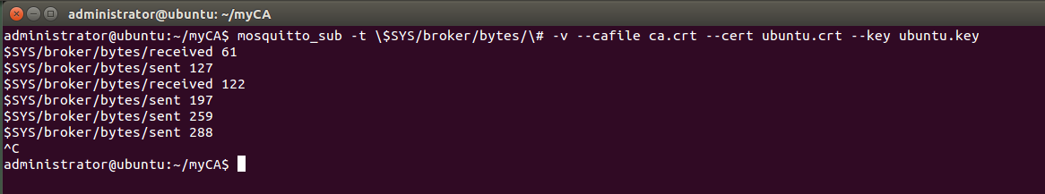

Adding the --cert and --key arguments satisfies the server:
$ mosquitto_sub -t \$SYS/broker/bytes/\# -v --cafile ca.crt --cert client.crt --key client.key

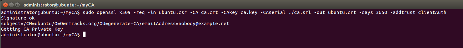

To be able to obtain the corresponding certificates and key for my server (named ubuntu), use the following syntax:
And run the following command:
