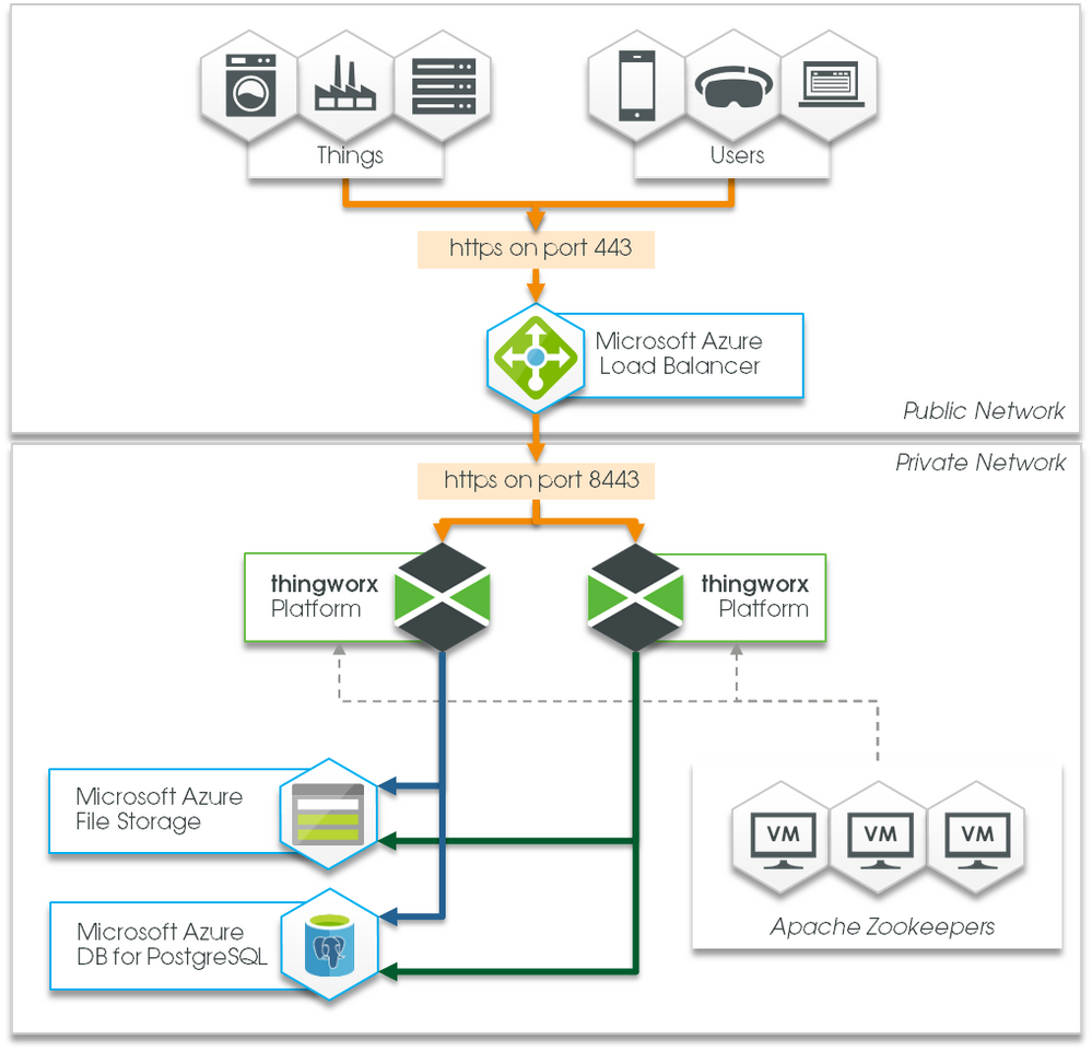

High-Level Diagram:
ThingWorx High Availability with Azure Load Balancer
To keep this article focused, we will not go into the setup of ThingWorx in a High Availability architecture. It will be assumed that ThingWorx is working correctly and the ZooKeeper cluster is managing failover for the Platform instances as expected. For more details on setting up this configuration, the best place to start would be the High Availability Administrator’s Guide.

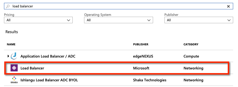

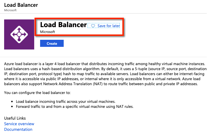

Step 1: Select SKU
Search for “load balancer” in the Azure market and select Load Balancer from Microsoft
Verify the correct vendor before you create a Load Balancer.

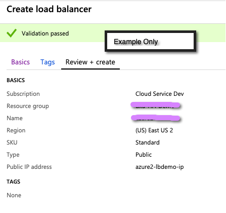

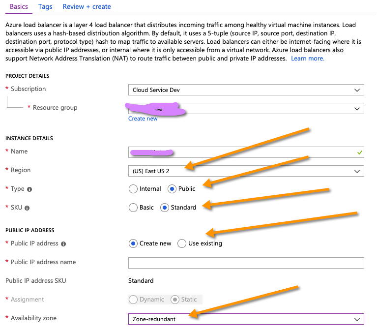

Step 2: Create load balancer
To create a proper load balancer, make sure to read Microsoft’s What is Azure Load Balancer? overview to understand the differences between “basic” and “standard” SKU offerings. If your IT policy only requires SSL communication to the outside but doesn't require a SSL communication in a health probe, then the “basic” SKU should be adequate (not considering zone redundancy).
You have to decide following parameters:
  • Region
  • Type (public or Internal)
  • SKU (basic or standard)
  • IP address
  • Public IP address name
  • Availability zone
PTC cannot provide specific recommendations for these parameters – you will need to choose them based on your specific business needs, or consult Microsoft for available offerings in your region.

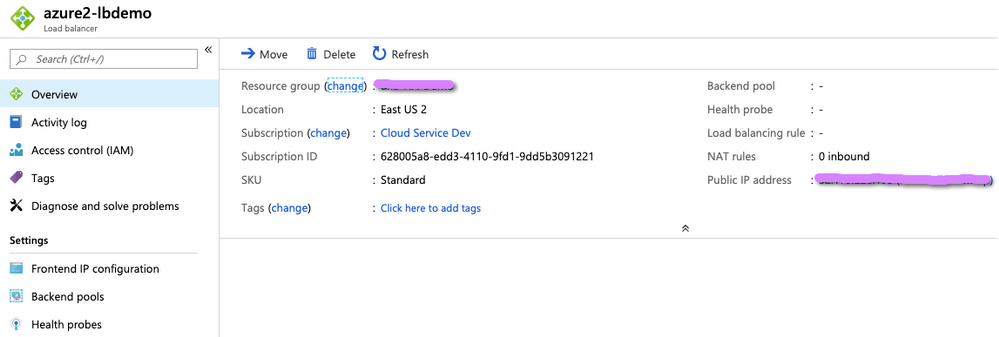

Step 3: Start to configure
Once a load balancer is successfully created by Azure, You should be able to see:

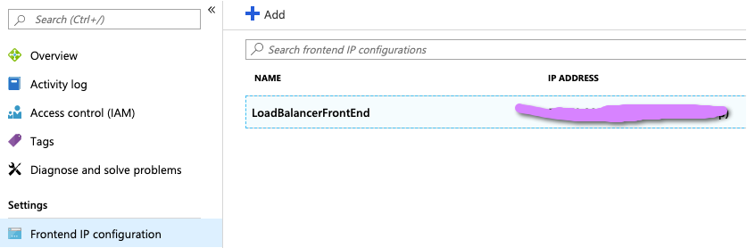

Step 4: Confirm frontend IP
Click frontend IP configuration at left side and you should be able to see public IP address configuration.
Please make sure to register this IP with your domain name (edc.ptc.io in our example) in your Domain Name Server (DNS). If you unfamiliar with DNS configuration, you should consult with the administrator of your DNS server. If you are using Azure DNS, this Quickstart article on creating Azure DNS Zones and records may help.

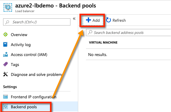

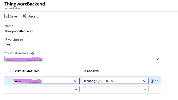

Step 5: Configure Backend pools
Click Backend pools and click “Add” to add a backend pool definition.
Select a name for your Backend pool (using ThingworxBackend in our example). Next step is to choose Virtual network.

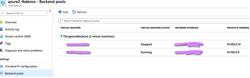

Once you select Virtual network, then you can choose which VM (or VMs) you want to put behind this load balancer. The VM should be the ThingWorx VM instance.
In a high availability architecture, you will typically need to choose two instances to put behind this load balancer.
Please Note: The “Virtual machine status” column in this table only shows VM status, but not ThingWorx status. ThingWorx running status will be determined by the health probe configured in the next step.

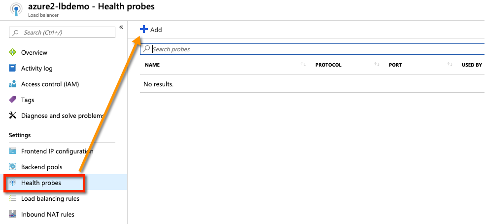

Step 6: Configure Health Probe
Health Probe will be used to determine the ThingWorx Platform’s running status. When a ThingWorx Platform instance is running as the leader, then it will give HTTP status code 200 during a health probe. The Azure Load Balancer will rely on this status code to determine if the platform is running properly.
When a ThingWorx platform VM is not responding, offline, or not the leader in a High Availability setup, then this health probe will provide response with a different HTTP status code other than 200.
For the health probe, select HTTPS for the protocol. In our example port 8443 is used, though another port can be selected if necessary. Then, provide the “/docs/pings.jsp” we created earlier as the probe’s path. You may need to change this path value if you put this file in a different location.

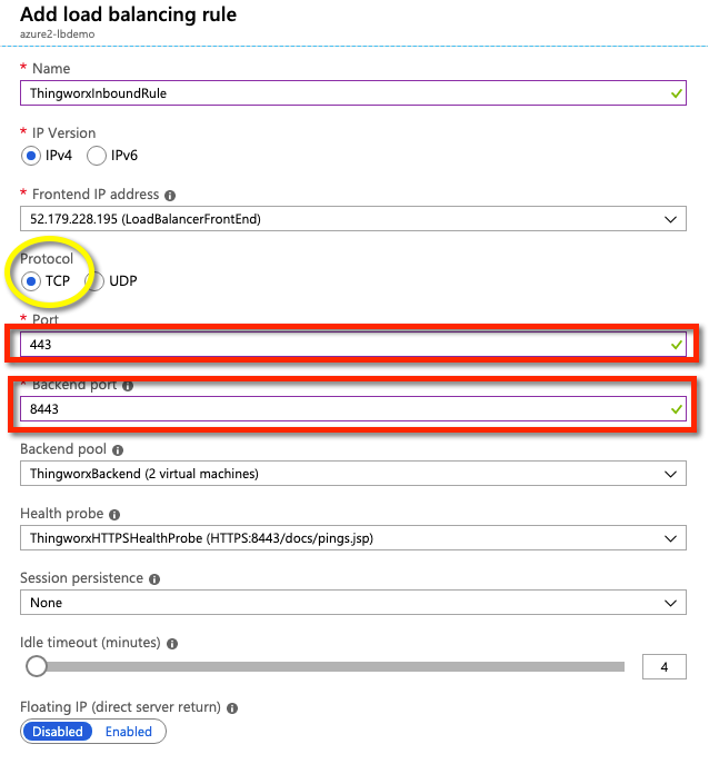

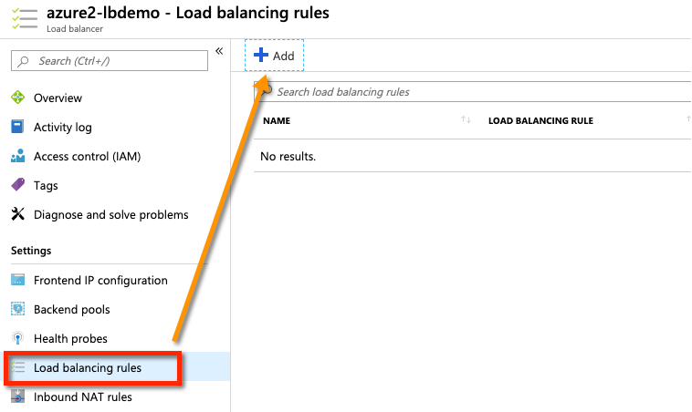

Step 7: Configure Load balancing rules.
Select “Load balancing rules” from left side and click “Add”
Select TCP as protocol, in our example we are using 443 as front-end port and 8443 as back-end port. You can choose other port numbers if necessary.
Reminder: Azure Load Balancer is a layer 4 (Transport Layer) router – it cannot differentiate between HTTP or HTTPS requests. It will simply forward requests from front-end to back-end, based on port-forwarding rules defined.

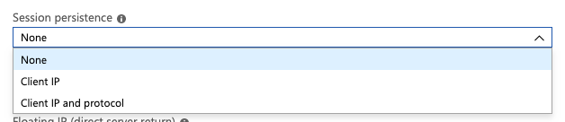

Session persistence is not critical for current versions of ThingWorx as only one active node is currently permitted in a High Availability architecture. In the future, selecting Client IP may be required to support active-active architectures.

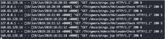

Step 8: Verify health probe
Once you complete this configuration, you can go to the $CATALINA_HOME/logs folder and monitor latest local_access log. You should see similar entries as pictured below - HTTP 200 responses should be observed from the ThingWorx leader node, and HTTP 503 responses should be observed from the ThingWorx passive node.
In the example below, 168.63.129.16 is the internal IP Address of the load balancer in the current region.

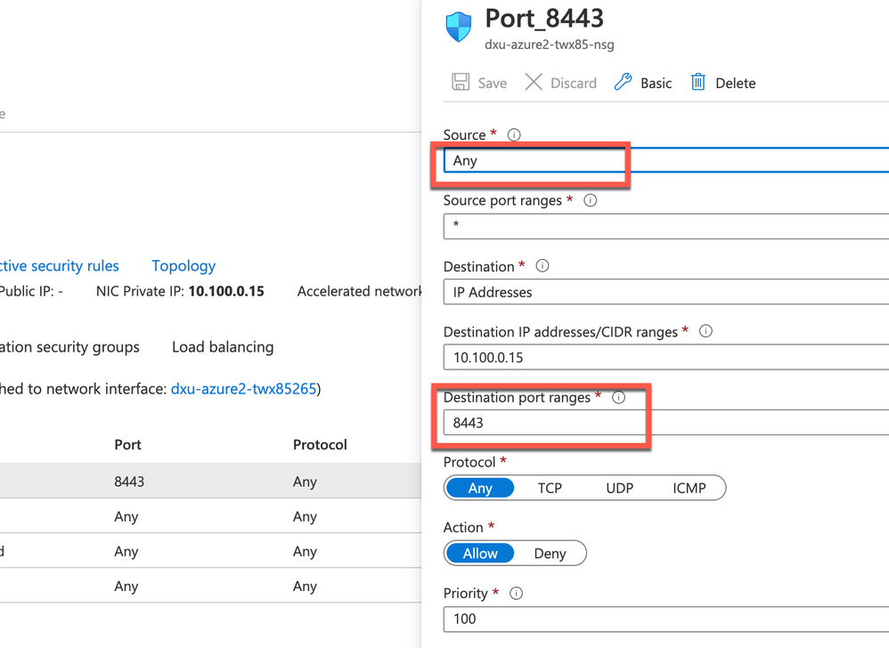

Step 9: Network Security Group rules to access Azure Load Balancer
On its own, Azure Load Balancer does not have a network access policy – it simply forwards all requests to the back-end pool. Therefore, the appropriate Network Security Group associated with the backend resources within the resource group should have a policy to allow access to the destination port of the backend ThingWorx Foundation server (shown as 8443 here, for example). The following image displays an inbound security rule that will accept traffic from any source, and direct it to port 443 of the IP Address for the Azure Load Balancer.

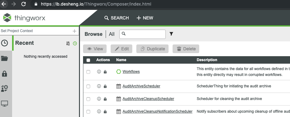

Enjoy!!
With the above settings, you should be able to access ThingWorx via: https://edc.ptc.io/Thingworx (replacing edc.ptc.io with the hostname you have selected).
