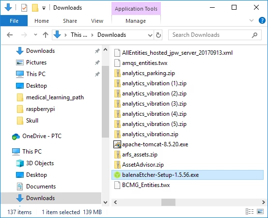

5. Download the balenaEtcher "flasher" software.
6. Navigate to the download location and locate the balenaEtcher .exe file.
7. Double-click on the balenaEtcher .exe to begin the installation process.
8. On the balenaEtcher installer pop-up, click I Agree.
