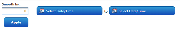

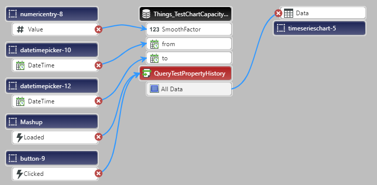

  7. Create a Mashup for displaying the property data and capacity of the query to smooth the data. The Mashup should run the service created in step 4 on load. The service input comes from widgets on the mashup:
    Bindings:
  8. Place a Time Series Chart widget in the bottom of the Mashup layout. Bind the data from the query to the chart.

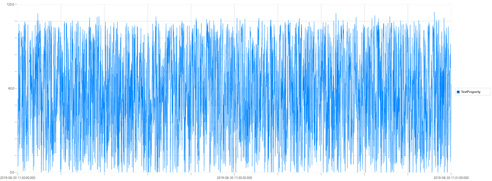

  9. View the Mashup. Note the difference in the data...
    All points in one minute:

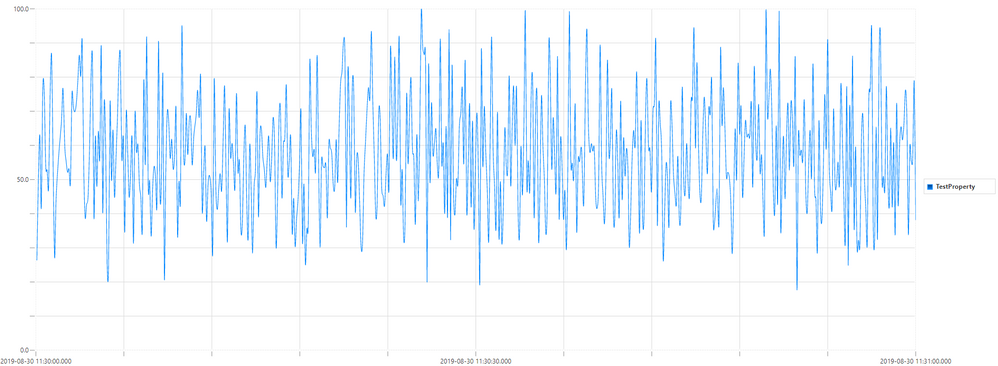

    And a smooth factor of 10 in one minute:
    Note that the outliers still appear, and the peaks are much easier to see. With fewer points, trends become easier to spot and data is easier to understand. For monitoring the specific nature of the outliers, utilize alerts and other types of displays. Alternative forms of data reduction could involve using the mean of each interval (given by the smoothing factor) or the min or max, as needed for the specific use case. Display multiple types of these options for an even more detailed view.
