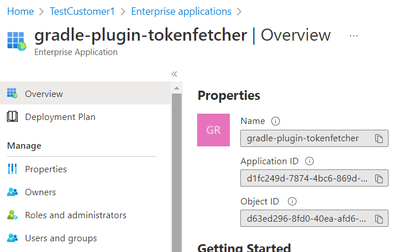

- Navigate to “App Registrations” from the Azure AD page in Azure Portal and then click “New registration”
- Enter the application name (ours is called “gradle-plugin-tokenfetcher” in the examples shown here), and select the “single tenant” radio button
- Enter a URL for redirect URI and for “Select a platform” select “Web”
- Click “Register”, and wait for the application created notification

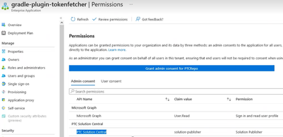

- Now we need to add permissions to see Solution Central
- Open the app from under “App registrations” and select the “API permissions” tab

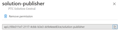

- Click “Add a permission” and in the pop-up window that appears, select the “APIs my organization uses” tab, which should have PTC Solution Central listed, if this tenant has been linked to the PTC tenant per step 2 above
- Select “Application Permissions” and then check the “solution-publisher” role
- Click “Add permissions”
- The application now has access to Solution Central as a publisher, able to send solution publications over the API and not just via the Platform interface

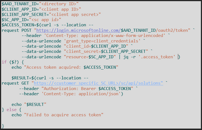

- Using Windows Powershell or something similar, create a script to make a couple of cURL requests against first the Azure AD and then the Solution Central API (attached as well):
The tenant ID and the directory ID are the same value (listed on the tenant under “Overview”), and the client ID and application ID are the same as well (listed on the application, shown here), so don’t be confused by terminology- The client app secret is the “Value” provided by the system when a new client secret is created under “Certificates & Secrets” (remember to copy this as soon as it is made and before clicking away, as after that, it will no longer be visible):
The Solution Central app ID can be found under “App registrations”, listed within the details for the “solution-publisher” role:- This access token request piece must be done before every request to the SC API, so this secret should be kept in some kind of password management tool (or a global environment variable in GitLab) so that it isn’t found anywhere in the source code
- If the script pings the SC API successfully, then a list of solutions will be returned
