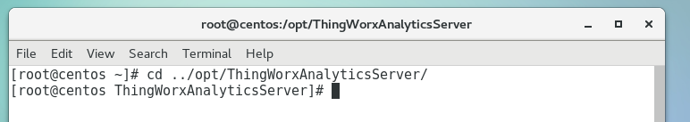

1. Change directory to the installation destination of the ThingWorx Analytics (TWA) Application.
    1. In the screenshot below, the application is installed to the /opt/ThingWorxAnalyticsServer directory

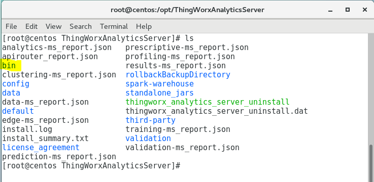

2. In the install directory, there are a series of folders and files. You can use the ​ls​ command to see a list of files and folders in the installation directory.
    a. You will need to go navigate one more level down into the ./ThingWorxAnalyticsServer/bin​ ​directory by using command ​cd ./bin​
    b. As you can see above, we used the ​pwd​ command to verify that we are in the correct directory.

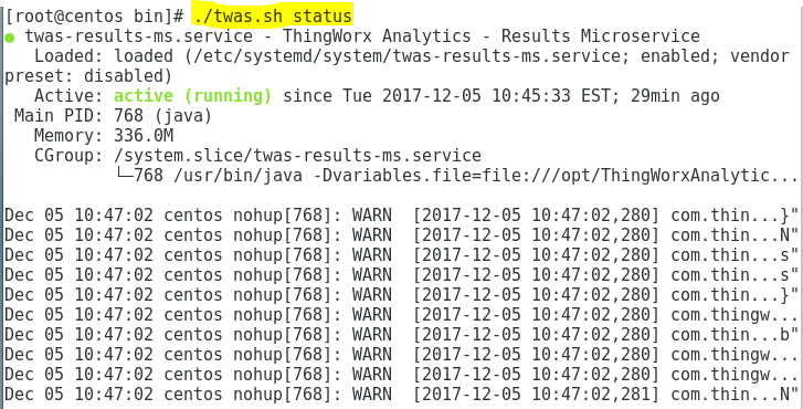

3. In the ./ThingWorxAnalyticsServer/bin directory, there should be three shell files: configure-apirouter.sh, configure-user.sh, and twas.sh
    a. To run a status check of the application, use the command ./twas.sh status
          i. This will provide a list of outputs, and a few warning messages. This is normal, see screenshot below:
    b. You will have a series of services, which will have a green active (running) or red not active (stopped).
          i. List of services:
      • twas-results-ms.service - ThingWorx Analytics - Results Microservice
      • twas-data-ms.service - ThingWorx Analytics - Data Microservice
      • twas-analytics-ms.service - ThingWorx Analytics - Analytics Microservice
      • twas-profiling-ms.service - ThingWorx Analytics - Profiling Microservice
      • twas-clustering-ms.service - ThingWorx Analytics - Clustering Microservice
      • twas-prediction-ms.service - ThingWorx Analytics - PredictionMicroservice
      • twas-training-ms.service - ThingWorx Analytics - Training Microservice
      • twas-validation-ms.service - ThingWorx Analytics - Validation Microservice
      • twas-apirouter.service - ThingWorx Analytics - API Router
      • twas-edge-ms.service - ThingWorx Analytics - Edge Microservice
