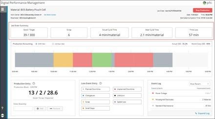

imageOne of the perks to building DPM on top of the ThingWorx Foundation is that many of the webpages (called “mashups”) within ThingWorx are already responsive, and any  which aren’t responsive OOTB can be modified and custom designed for different size viewing screens to ensure that if necessary, end users can access DPM   from a variety of locations and devices. Most of the time, end users will be accessing mashups from hard-wired dashboards mounted on the actual devices,    or from wireless laptops which have standard size screens with standard resolutions. For use cases involving phones or tablets, however, it may be necessary to see how DPM will perform across a variety of bandwidth and latency conditions. Often, cellular or satellite connection is a must to facilitate field team cooperation, and 5G networks often result in worsened performance.
So, to demonstrate the influence of bandwidth and latency on the responsiveness of DPM, the Production Dashboard was loaded in the Google Chrome browser repeatedly under varying conditions. This dashboard is the webpage most operators and field users would access to log event information and production details (so it is widely used by end users). This provides a sort of benchmark of the DPM solution, something which indicates what can be expected and tells us a few things about how DPM should be deployed and configured.

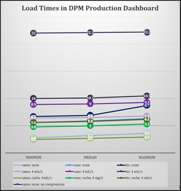

imageEven with bandwidth, every region sees better performance for return users versus new users, which may be important to note. However, because DPM field users most commonly access DPM often, the return user time is a better indicator of adoption, and those numbers look great in our simulations. Notice the top line which shows the very worst of mobile performance, what happens over networks with bandwidth when Tomcat Compression is not enabled. Load times vary only slightly for regular networks when Tomcat Compression is enabled, and they vastly improve performance across regions and on mobile networks, so it is highly recommended (instructions on how to enable are below).
Key Takeaways
Latency and bandwidth impact DPM performance in exactly the way one would expect of a web application. While any DPM server can be accessed from any region, regions with more latency will experience delays proportional to the amount of latency. In the chart here, find the three regions represented three times by three different colors (different from the charts above):
  • The three different shades of each color represent the different regions
  • Green represents the optimal configuration settings (Tomcat compression enabled, caching turned on) for returning users with bandwidth limitations (i.e. mobile networks like 5G)
  • Blue shows first-time page visitors with no bandwidth limitations
  • Purple shows first-time visitors that do have bandwidth limitations
  • The uncompressed first-time load for mobile users (those with bandwidth limitations imposed) within the same region is also given to demonstrate the importance of enabling Tomcat Compression (load times only get worse without compression the farther the region)
Notice how the green series has lower load times across the board than the blue one, meaning that return users even with bandwidth limitations have better performance across every region than new users. Also notice how the gap is larger between lighter colors and darker colors, where the darker the color, the farther the region from the DPM servers. This indicates that network latency has a more significant influence on performance versus bandwidth, with only longer running transactions like file uploads seeing a significant performance hit when on a network with bandwidth limitations.  Find out how to enable tomcat compression  and review the full solution benchmark in the document attached.
