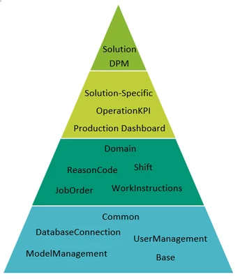

At PTC, building blocks are broken down in a couple different ways: categories and types. The category of a building block is primarily in reference to its visibility and availability for use by the greater ThingWorx community. We use our own framework here at PTC, so our solution offerings are based around solution-specific building blocks, things which we provide as complete, SaaS solutions. These solution-specific building blocks combine up into single solutions like DPM, offerings which require a license, but can then easily be deployed to a number of systems. PTC solutions provide many, complex, OOTB features, like the Production Dashboard of DPM, and the OperationKPI building block.
Anyone doing any sort of development with ThingWorx, however, does still have access to many other building blocks, included with the domain specific building block category. These are the pieces used to build the solution building blocks like DPM, and they can be used to build other more custom solutions as well. Take the OperationKPI block which can vary greatly from one customer to the next in how it is calculated or analyzed. The pieces used to build the version that ships with DPM are right there, for instance, Shift and ReasonCode. They are designed to have minimal dependencies themselves, meant to be used as dependencies by custom blocks which do custom versions of the module logic found within the PTC solution-specific blocks. Then there are the common blocks as well, and these are used even more widely for things like user management and database connectivity.

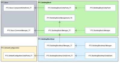

The last type of building block is the standard building block, which is the most generic. This one is not intended to be overridden, often serving as the combination of other building blocks into final solutions. It is also the most basic combination of components necessary to adhere to the building block design framework and interface with the shared deployment infrastructure. The necessary components include a project entity, which contains all of the entities for the building block, an entry point, which contains the metadata (name, description, version, list of dependencies, etc.) and overrides the service for automatic model generation (DeployComponent), and the building block manager.
The dashed arrows indicate an entity implements another, and the solid arrows, extension.The dashed arrows indicate an entity implements another, and the solid arrows, extension.
The manager is the primary service layer for the building block, and it makes most of the implementation decisions. It also has all of the information required to configure menus and select which contained mashups to use when combining modular mashups into larger views. The manager really consists of 3 entities: a thing template with the properties and configuration tables, a thing which makes use of these, and a thing shape which defines all of the services (which can often be overridden) which the manager thing may make use of.
