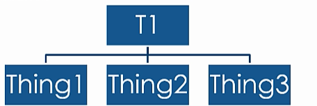

1. Create a new template T1, several things Thing1, Thing2, Thing3

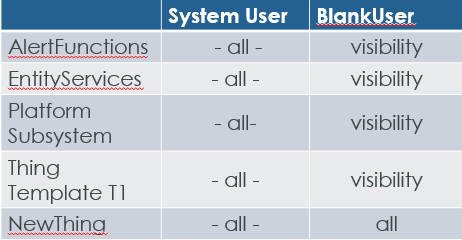

2. Create a new thing NewThing and a new user BlankUser
3. Create a service within NewThing that uses ThingTemplates[“T1"].GetImplementingThings() and give all the permissions to the new non-admin user, BlankUser
Now the service on the template T1 can be accessed through the NewThing without explicit permissions for the BlankUser but rather through the system user.

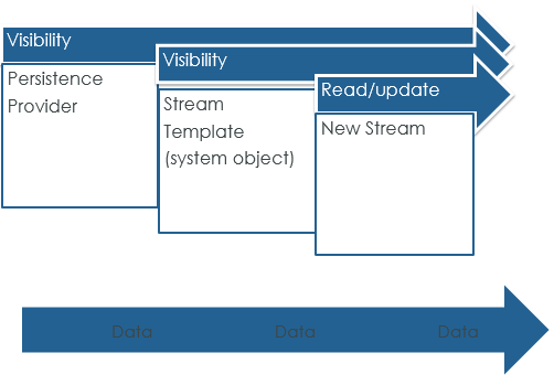

When manipulating with data (involving read/write and access to persistence provider), the BlankUser would require more than  just visibility permissions. For example, for a Stream, the following permissions would need to be set up:
1. Visibility on Stream template,StreamProcessingSubsystem, PersistenceProvider
2. Read/write permission on the Stream thing in the use case, created with the Stream template.
Similarly, for other sources of data, things, templates and resources involved need visibility and, depending on the scenario, read/write permissions on the specific template.
