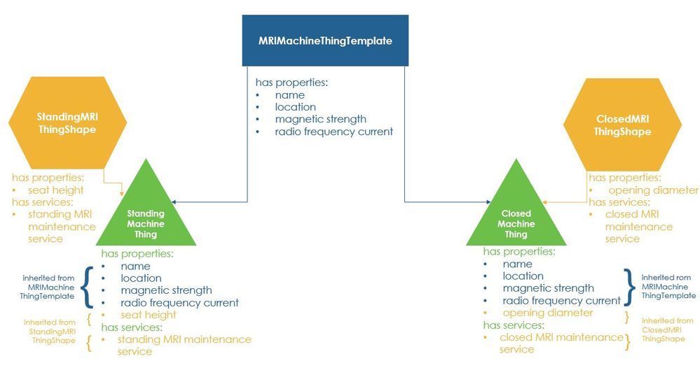

Let’s say we want to model a single closed MRI machine. We’ll represent the machine as a Thing that inherits from Templates and Shapes. We’ll start with the MRIMachineThingTemplate so that we can create an MRI Machine Thing (i.e., instance).
Since this is a closed MRI machine and has the additional property of opening diameter, we’ll want to make sure we include that property. To do this, we’ll add the ClosedMRIThingShape.
Viola! We now have a digital twin of our closed MRI machine with all the base properties of an MRI machines from our MRIMachineThingTemplate and all the special add-ons of the closed version with our ClosedMRIMachineThingShape.
Here’s a visual recap of what we just modeled.
