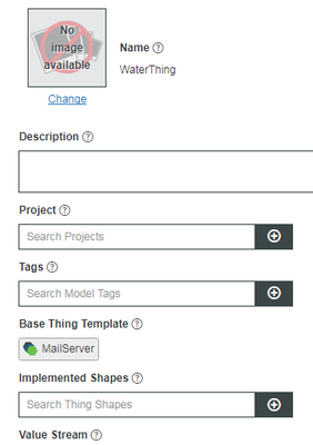

1. Create a Thing with the MailServer[i] as the Base Thing template.

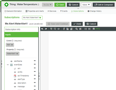

3. Enable the Thing Subcriptions by
  • Select Subscription and click +Add
  • Make sure to mark the checkbox Enabled
  • Selecting your Event name and your Property name
  • In the right side of the screen you can enter your script/function that will notify ThingWorx email service to create the email notification
  • Select Done and Save

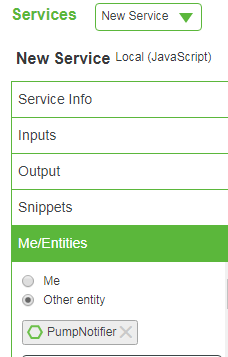

4. Enable Email notification by selecting Services
  • Provide an name
  • Select Me/Entities
  • Mark Other entity
  • Find your Thing where the MailServer is the Thing Template

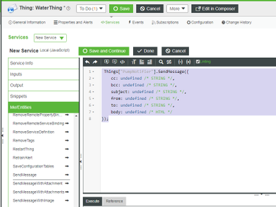

5. Then find the SendMessage snippet/script and fill out the snippet with your personal information.
