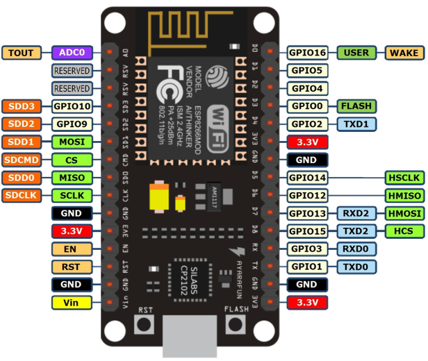

Wiring the DHT-11 sensor
The following image shows the PINs on the ESP8266
I'm using a DHT-11 sensor with cables included and already fixed to a board with 3 PINs.
In case you're using a different version, there might be additional components and wiring required, like a resistor etc.
Google might help here as well.
Ensure that neither board nor sensor are plugged in, and the ESP8266 is powered off.
To hook the sensor up to the ESP8266, join
  • ( - ) to GND
  • ( + ) to 3.3V
  • (out) to D3
After all the connections are made, connect the ESP8266 via USB to a computer / laptop with the Arudino IDE configured.
