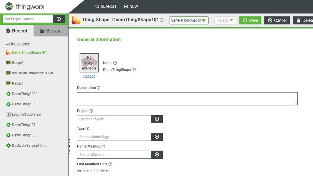

Via the ThingWorx Composer
  1. Navigate to the ThingWorx Composer > New > ThingShape
  2. Add an unique name to the ThingShape
  3. Notice during creation there's no ThingTemplate needed for selection, however behind the scene all Things in ThingWorx draw from base template called GenericThing
  4. Under Properties and Alerts section add required properties
  5. Finally, Save the entity
imageCreating ThingShape via ThingWorx Composer
