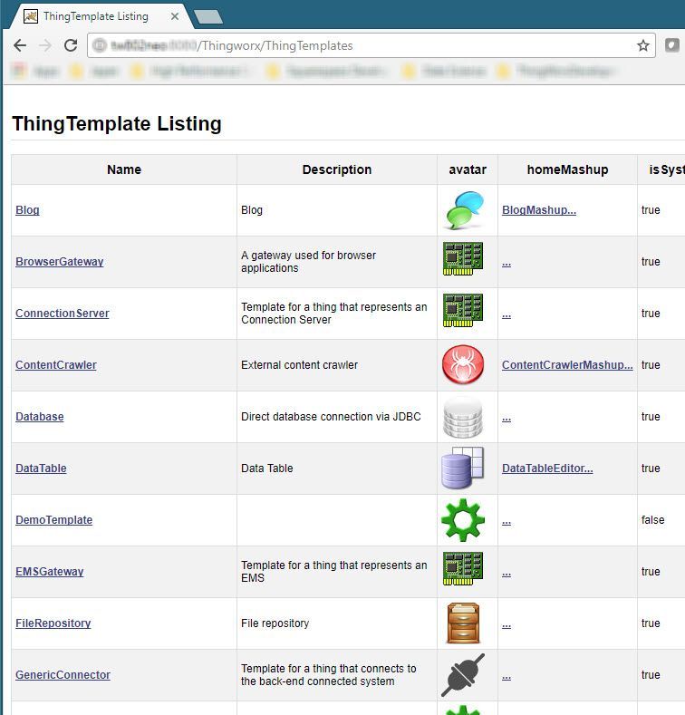

All the available ThingTemplates can be listed and reviewed by navigating to the /Server via the ThingWorx REST API. List of ThingTemplates can be reviewed by using one of the following :
  • <serverName>:<portNumber>/Thingworx/Server in a web browser and then locate and click on the ThingTemplates, or by;
  • Typing <serverName>:<postNumber>/Thingworx/ThingTemplates in the web browser
Either of the above listed options will display the following list in the web browser
imageList of ThingTemplates
List shows all available ThingTemplates i.e. ThingTemplates that were provided OOTB and the ones that were created by the users as well. Using the column isSystemObject one can verify if the displayed ThingTemplate is provided OOTB or is custom one created by the user.

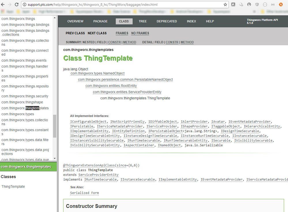

Accessing ThingTemplate Class description / details
This is covered under the JavaDocs for the ThingWorx Platform API, which can be accessed via the API Documentation
Search for ThingTemplate for following result
imageAPI Documentation: ThingTemplate
