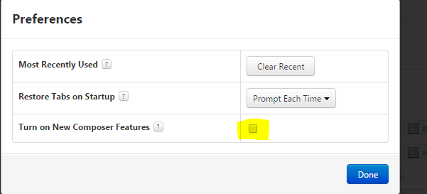

Do we have new composer out yet? I saw new composer in Release notes but when I installed it is same old composer overall.
June 14, 2017
You will have to turn on preferences. Go to Administrator Icon ( Top Right corner) in Composer-> Select Preferences -> Select Checkbox Turn on New Composer Features.
Once done you will see New Composer option. Click it to explore new composer !!
-Durgesh
June 14, 2017
Thanks for prompt response. Appreciate it!!
