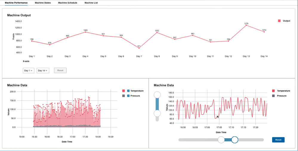

imageMashup in 9.0 with new Line Chart widgets!

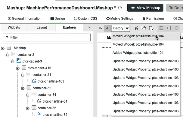

Undo/Redo
Ever spent a good half hour arranging a layout, making some data bindings, adding some styles, and once you view the Mashup, you decide you aren’t quite happy with your last few tweaks? The panic sets in when you forget exactly what you changed, and you don’t want to lose all of your edits. What is a developer to do? In older versions of ThingWorx, you might cancel without saving your edits or you might try to surgically get back to a good state. Either way, you were not a happy developer.
ThingWorx 9.0 will make you happy again. All actions in the Mashup are now tracked by an undo/redo buffer. Buttons are now available in the toolbar to help you revert actions. An action history drop-down is also available if you want to undo or redo a few jumps at once. Sometimes, it’s the little things!

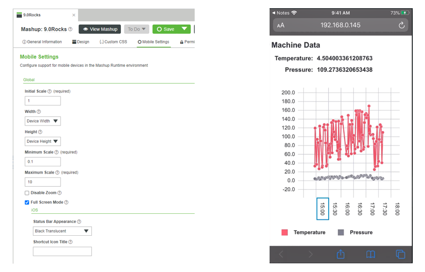

In 9.0, we now have introduced a new Mobile Settings configuration editor on the Mashup. This allows you to define for mobile browsers your scaling and width as well as your height and zoom settings. There are even iOS-specific settings for shortcuts and the status bar.
imageMobile Settings Editor and iPhone view of a 9.0 Mashup.

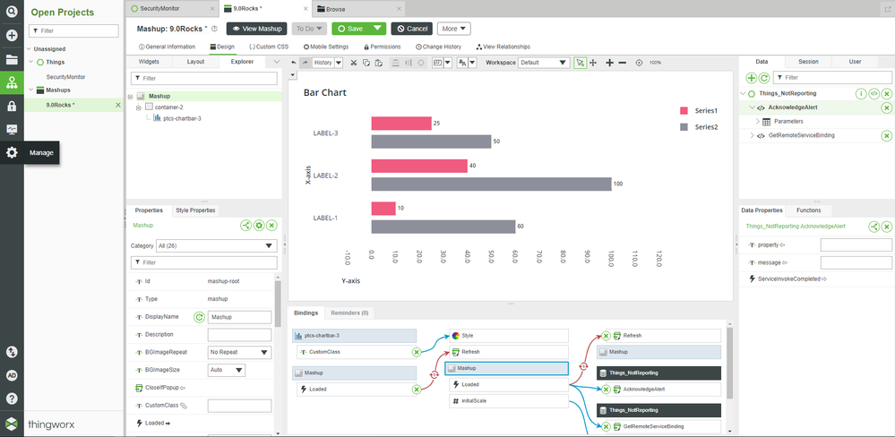

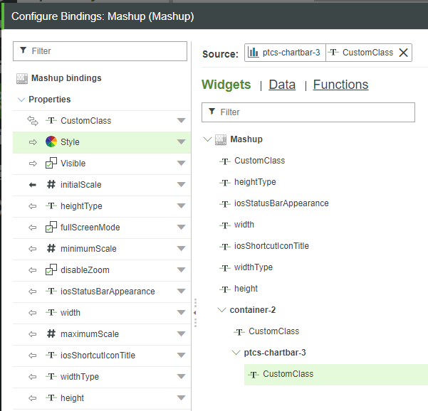

The heart of any application is the data, and how it is leveraged in the UI. For Mashups, there many good ways to do that with our drag-and-drop functionality or our Bindings panel. But in 9.0, we have completely revamped the Configure Bindings Dialog. You’ll quickly notice when you open the new dialog that it has a more usable interface with more screen real estate to explore services, properties, sources and targets. There is now a good separation between the Widgets, Data and Function sources, which makes things easier to locate and build. You’ll also see, if you’ve made bindings already, the complete map of bindings for your context. New search enhancements and target bindings chip-based filters are also now added.
imageNew Configure Bindings Dialog

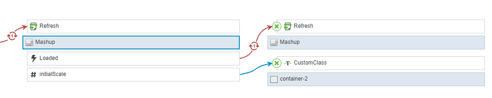

Another cool feature is that the bindings graph in the dialog will also show you any circular references you may have inadvertently created. If you can see in the diagram below, the red circle icon with a number 1 inside of it—this is almost always a bug, so we may as well tell you about it!
imageNew Circular references checking!

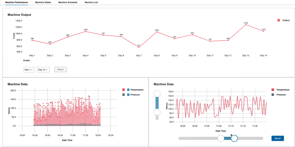

If you look at almost any IIoT application, you’re almost sure to see a chart. IIoT decisions are always centered around looking at telemetry and KPIs at specific moments of time, events, history, and future projections. ThingWorx has new charts in 9.0 for Line, Bar, and Schedule. They look sharp, they are powerful, and are a true upgrade over the former ThingWorx charts.

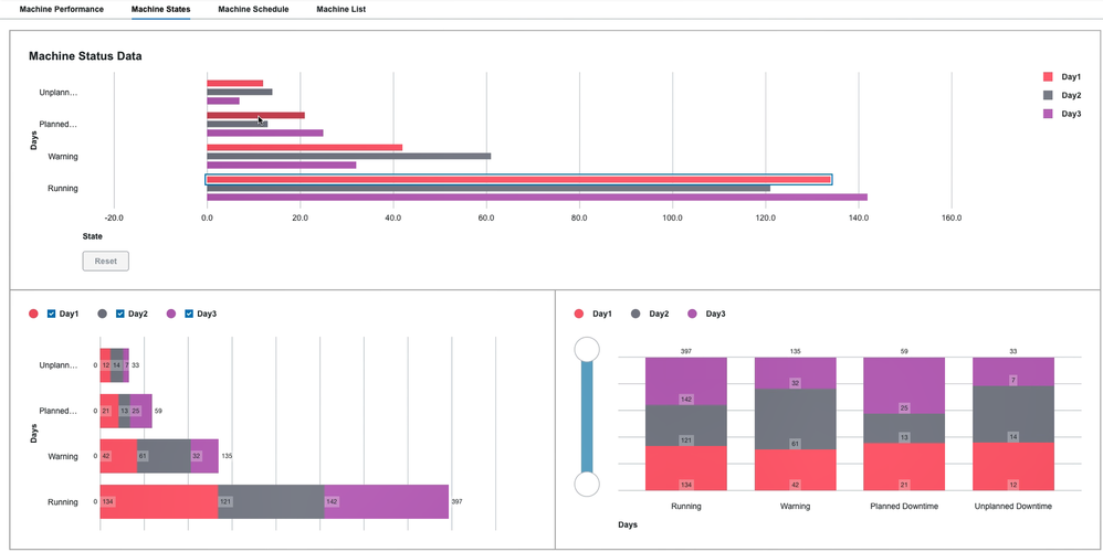

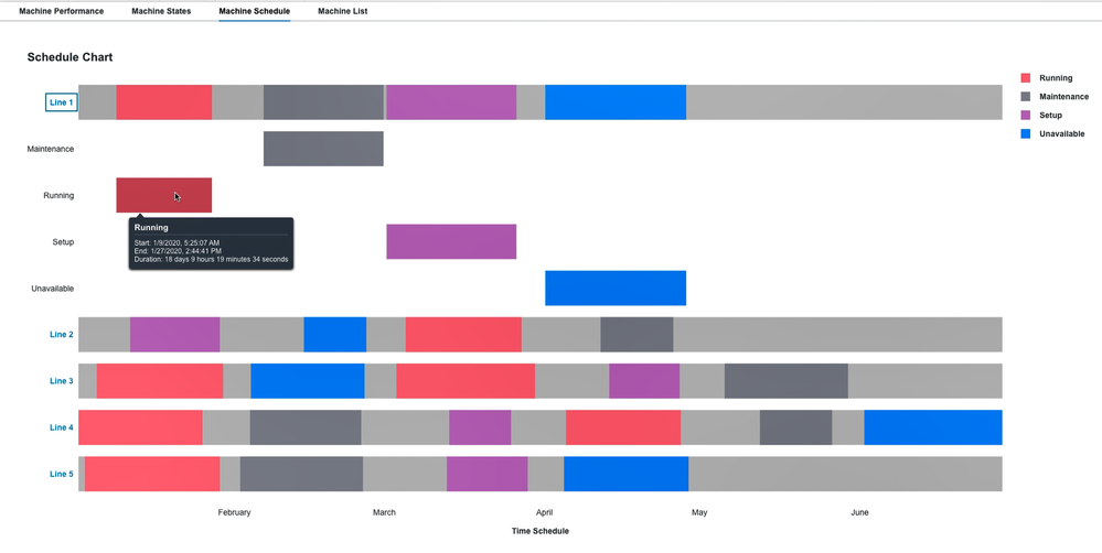

Here are some highlights. All are based on D3 framework and follow the PTC Design System. The Line chart also supports sub types of Run, Step, Area, Streamgraph and Scatter plot. The Bar chart also supports a column-based view. The Schedule chart is a great way to visualize downtime events, production orders, machine states, or device alarms. All charts feature responsive layout, advanced performance and data sampling, tooltips, multiple series support, multiple orientations for legends and axis labels, and plenty of styling and data configurations. They also all have great zooming capability for larger data sets including horizontal and vertical pan, drag/lasso zoom, interval controls, range zoom and zoom slider controls.
imageLine Charts with filters, zoom sliders, and markers
imageBar Charts with zoom sliders, horizontal and vertical orientations, and configurable legends
imageSchedule Chart with drilldown and hover tooltips

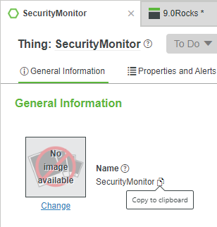

One more bonus feature to highlight! We now have quick copy buttons in common places in the interface where you might want to copy entity names or application keys. Just click and that text is in your clipboard. Very handy for searching or making bindings!
imageQuick copy buttons on entity names

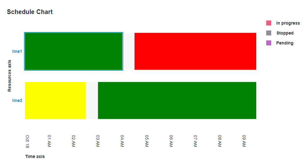

I was testing around with the new schedule chart widget and have some questions:
when I define a color for a resource in the data datatable it works for the graph but the legend uses the default color the event had without defining a color. Is this behaviour intended?
Also is there an option to disable the clickability/detail view of the resource? I can disable the schedule chart to achieve this but then i can't use the legend filter option.
Oct 19, 2020 8:27 AM UTC
I have the same question about Schedule Chart legend - how to customize its colors?
Or should it take values from input data but it's not working properly? image
In progress should be green, Stopped red and Pending yellow.
