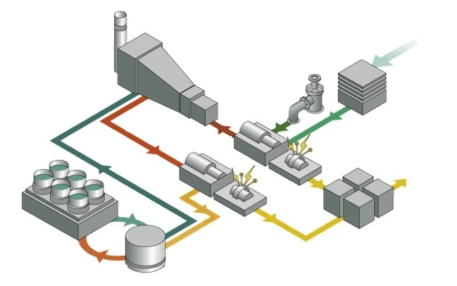

0:37 – Use Case: Combined Cycle Power Plant (CCPP) Dataset & Electrical Output Prediction Introduces the combined cycle power plant scenario, explaining how gas and steam turbines plus a heat recovery system generate energy, and the CCPP sensor dataset of temperature, pressure, humidity, and exhaust vacuum used to predict and optimize electrical output.
