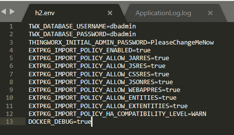

In Docker Desktop on a Windows machine, create a file called whatever.env and list the parameters as shown here:
Then, reference this environment file when bringing up the machine using the following command in Powershell:
