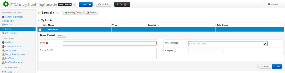

To create a new custom event:
  1. In ThingWorx Composer, open up the Thing, Thing Template, or Thing Shape for edit where the new Event will be added
  2. From the sidebar menu under Entity Information, select Events
  3. Click Add My Event
  4. Provide the event with a name and a data shape that describes the data being sent to a subscriber
  5. Click Done and Save
Once created, the event appears on the Subscriptions page for subscribing.  Since the event is custom built, you must specify when it triggers.  This is often accomplished from within a service.
