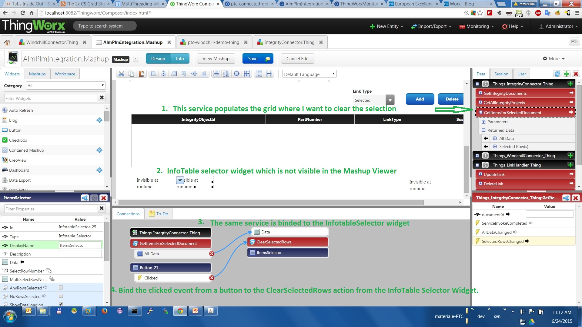

ThingWorx - How to deselect rows in Grid
In the ptc-windchill-extension-1.0.0-14.zip archive there is an extension called infotableselector_ExtensionPackage.zip​ . This extension enables the use of the Widget called Infotable Selector, which can be used to clear the selection in a grid.
For how to use this widget, take a look at the picture:

you can download it from ptc marketplace. It's called PTC Windchill Extension.
