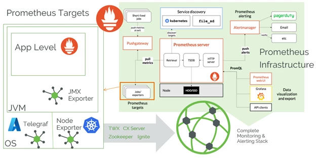

    There are many monitoring options available, but in our experience one of the easiest and most effective monitoring stacks to use with ThingWorx is Prometheus for metrics gathering with Grafana for metrics analysis and review. In a mature monitoring stack, Telegraf is also commonly installed on each VM/host to gather the system metrics (like CPU and Memory usage, things we’ve stated are good metrics of system performance and stability in past articles on scale and size testing) and output them in Prometheus format.
    Prometheus is a highly scalable open-source monitoring framework that contains out of the box monitoring and alert capabilities for Kubernetes-based deployments (not covered in this article). Using Prometheus is very simple because the ThingWorx application exposes a metrics endpoint which is formatted directly for use by Prometheus. There is also built-in alerting in Prometheus, but not the ability to form dashboards for reviewing data or screenshotting it for documentation purposes. That’s where Grafana comes into play. Grafana has a preconfigured Prometheus-type data source and many preconfigured dashboard templates for various applications and services. Telegraf is also easily imported into Grafana, as is shown in the section below.
The Prometheus targets in the larger diagram are expanded out on the left. For each target, some tool exports the data in a syntax which Prometheus can scrape. For VMs, this can be Telegraf, for Kubernetes, the Node Exporter. JVM has a JMX Exporter, and other tools like CX Server use Graphite. Many apps already have a Prometheus endpoint built-in, like ThingWorx and Zookeeper. Telegraf is not strictly necessary; the node exporter can also be used on VMs, but Telegraf is the more common choice since it is a more mature dev ops tool.The Prometheus targets in the larger diagram are expanded out on the left. For each target, some tool exports the data in a syntax which Prometheus can scrape. For VMs, this can be Telegraf, for Kubernetes, the Node Exporter. JVM has a JMX Exporter, and other tools like CX Server use Graphite. Many apps already have a Prometheus endpoint built-in, like ThingWorx and Zookeeper. Telegraf is not strictly necessary; the node exporter can also be used on VMs, but Telegraf is the more common choice since it is a more mature dev ops tool.
    Once Prometheus is scraping the targets, alerting on them can be done with OOTB Prometheus functionality, and dashboards for monitoring can be made easily in Grafana (with built-in support as well). This stack does not include the diagnostics piece, something which triggers thread dumps or the like when issues do occur. There are too many ways to conduct a successful diagnostic piece to cover here.

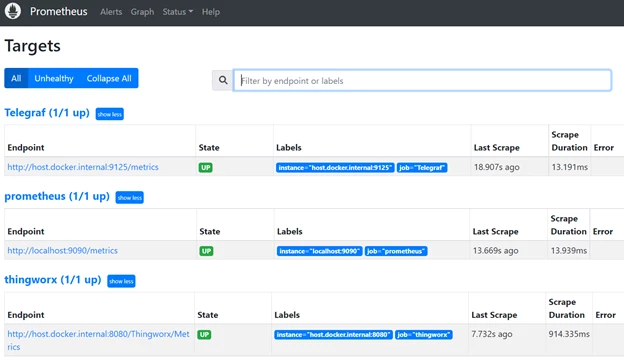

    The localhost endpoints are accessible in a browser. ThingWorx defaults to localhost:8080 endpoint. Prometheus defaults to localhost:9090. Telegraf is on port 9125. Open any of these in a browser tab to see the full monitoring stack. You can see easily if Prometheus is working by clicking “Status” > “Targets” at localhost:9090:
    If all of the targets appear as blue and say “last scrape” and a time stamp, then they’re working as expected. If they don’t, ensure you have the right ports, that there aren’t any firewall issues (if things aren’t all on localhost), and that everything is running without errors.
