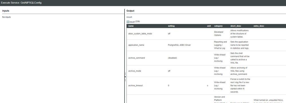

2. GetAllPSQLConfig
- Provides runtime details on all the configurations done in the postgresql.conf which are in-effect
- For detail on pg_settings see Postgresql 9.4 Doc

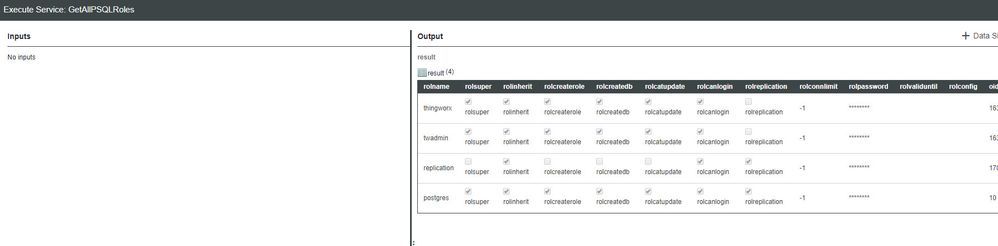

4. GetAllPSQLRoles
- Lists all the database roles/users
- Also lists their access rights permissions together with OID
- Helpful in identifying if the role is active/inactive or carries any limitation on the DB connections

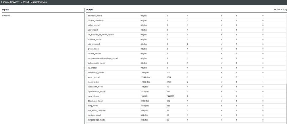

11. GetPSQLRelationIndexes
- Gets information on the Indexes
- Information like index size, number of rows, table names on which the index is created

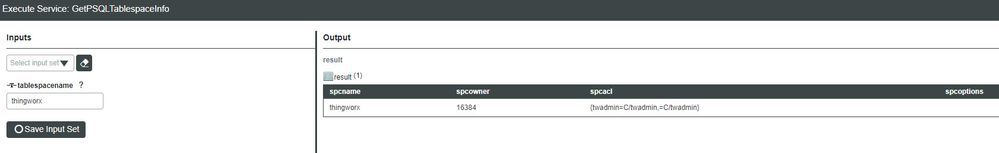

13. GetPSQLTablespaceInfo
- Takes tablespace name as input (String DataType), service defaults to 'thingworx' - modify if needed
- Fetches information like owner oid, tablespace ACL

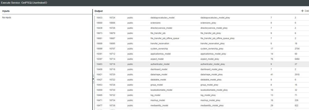

14. GetPSQLUserIndexIO
- Fetches index that are created only on the User created DB objects
- Shows relations (table) vs index relations ids (index on table), together with their names
- Also shows additional info like number of disk blocks read from this index & number of buffer hits in this index

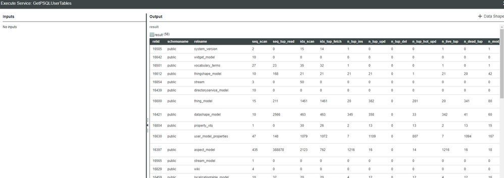

17. GetPSQLUserTables
- Fetches all the user created tables, together with their
  • name, OID
  • Disk I/O
  • Last auto vacuum , vacuum
  • Also lists the amount of rows each relation (table) has
