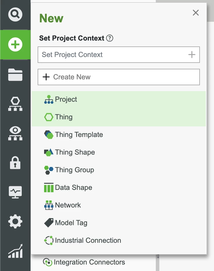

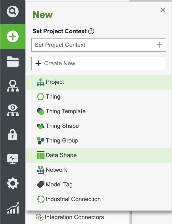

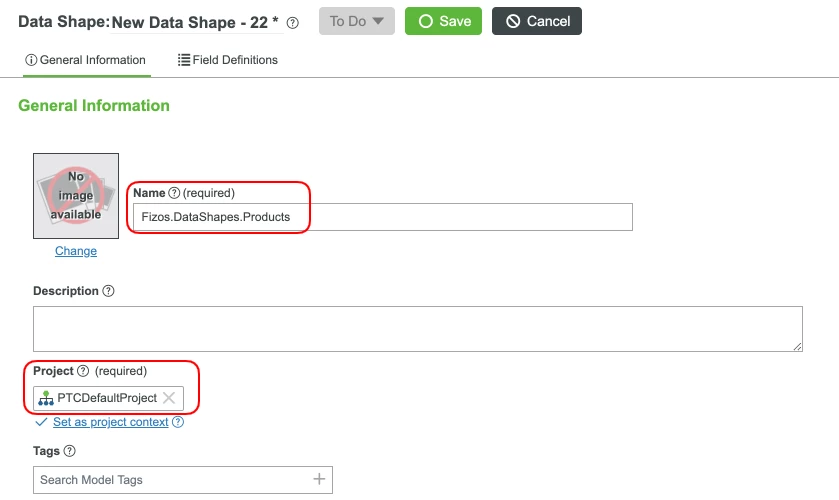

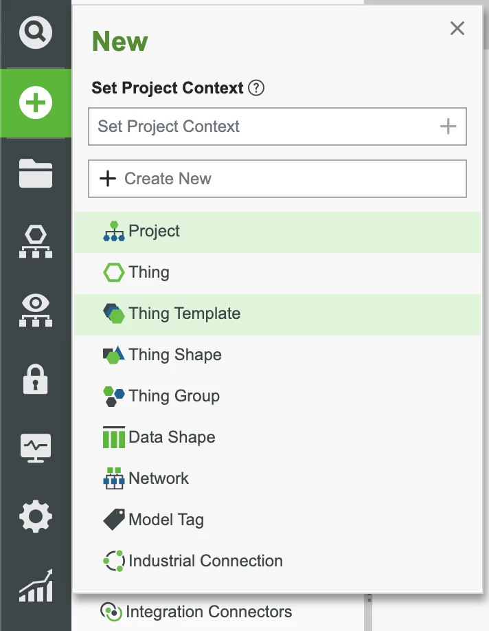

    1. In the ThingWorx Composer, click the + New in the top left of the screen.
    2. Select Data Shape in the dropdown.

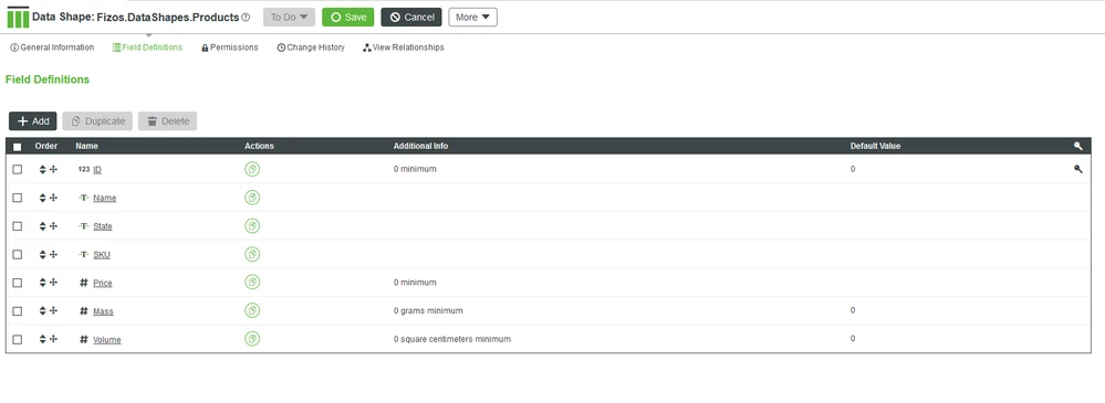

3. In the name field, enter Fizos.DataShapes.Products. This data shape will form high level information about our differing products as a whole.
4. Set the Project (ie, PTCDefaultProject) and click Save to store all changes.

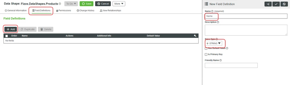

5. Click on the Field Definitions tab.
6. Click the + Add button and enter Name in the Name field of the new Field Definition.
7. Setup your Field Definitions to match the below definitions:
 Name      Base Type       Aspects
IDIntegerPrimary Key. Default 0. Minimum 0.
NameStringN/A
StateStringN/A
SKUStringN/A
PriceNumberMinimum 0.
MassNumberDefault 0. Minimum 0.
VolumeNumberDefault 0. Minimum 0.

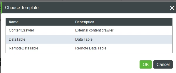

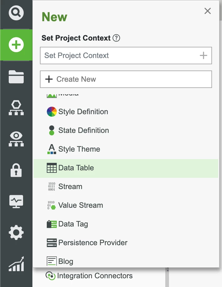

  2. Select Data Table in the dropdown and select Data Table in the prompt.
  3. In the pop-up, select Data Table.
  4. In the name field, enter Fizos.DataTables.Products. All of our product line will fit this abstract entity.
  3. In the name field, enter Fizos.ProductsEvent and in the Project field, select an existing Project (ie, PTCDefaultProject). All of our product line will use this DataShape as an alert/event.

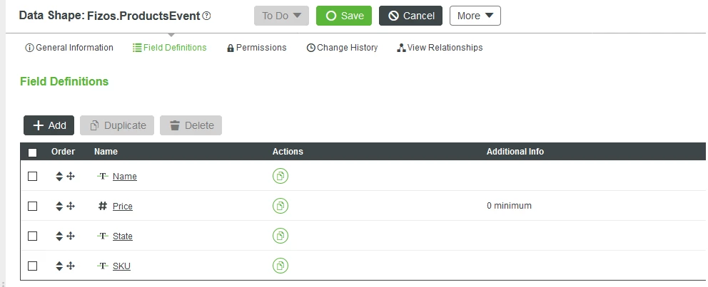

  4. Click Save to store all changes, then click Edit. Performed the steps used earlier to create the below properties for the Fizos.ProductsEvent Data Shape:
StateStringN/A
SKUStringN/A
NameStringN/A

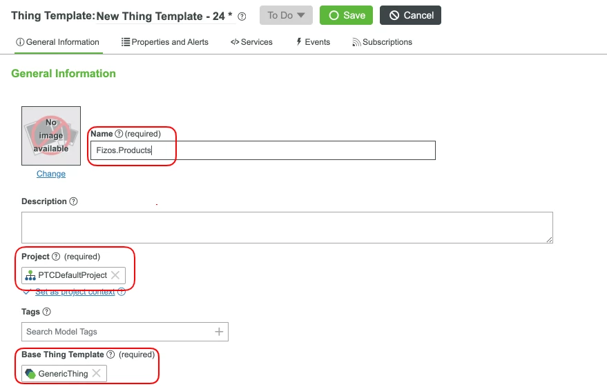

    2. Select Thing Template in the dropdown.
3. In the name field, enter Fizos.Products as the name and GenericThing as the Base Thing Template.
4. Select a Project (ie, PTCDefaultProject) and click Save to store all changes.

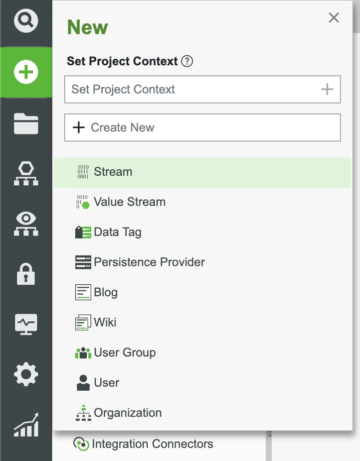

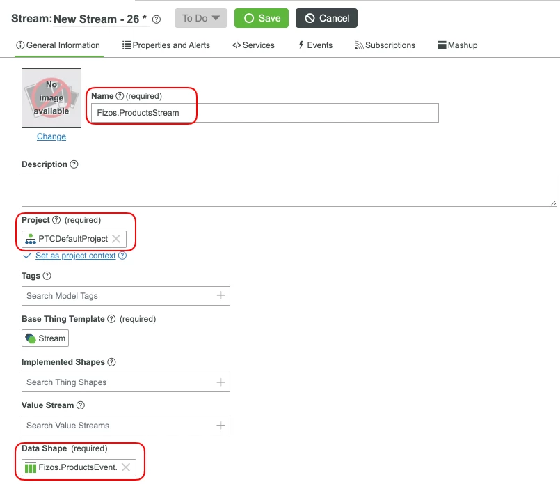

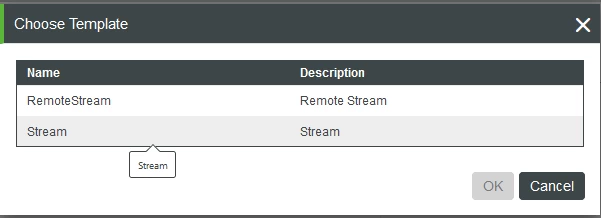

    2. Select Stream in the dropdown.
3. Select Stream in the pop-up.
4. In the name field, enter Fizos.ProductsStream and set the Project field (ie, PTCDefaultProject).
5. In the Data Shape field, select Fizos.ProductsEvent.
6. Click Save to store all changes.

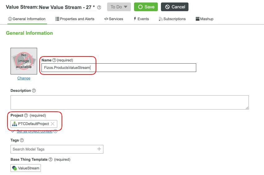

Now, the Value Stream.

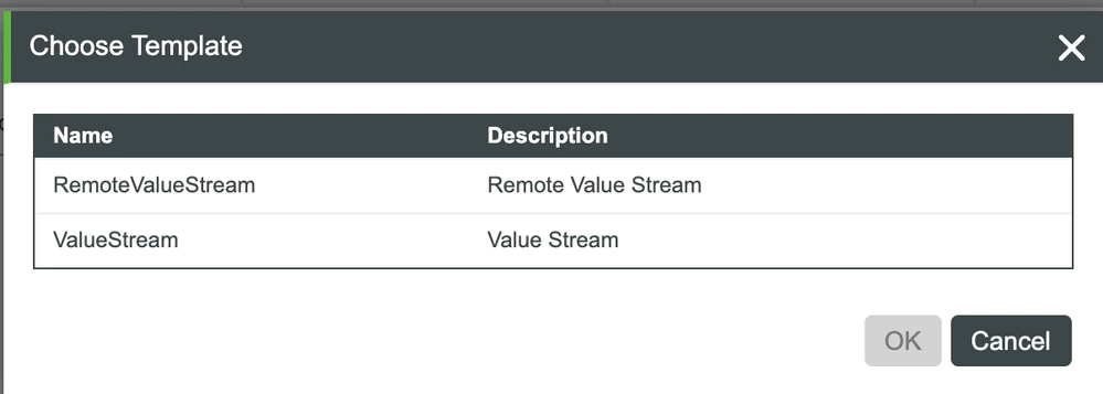

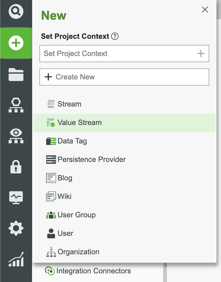

    2. Select Value Stream in the dropdown.
3. Select ValueStream in the pop-up.
4. In the name field, enter Fizos.ProductsValueStream.
5. Set the Project field (ie, PTCDefaultProject) and click Save to store all changes.
6. Open the Fizos.Products Thing Template and set the Fizos.ProductsValueStream as the Value Stream.

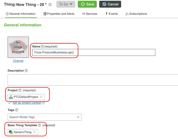

    2. Select Thing in the dropdown.
    3. In the name field, enter Fizos.ProductsBusinessLogic. All of our product line will fit this abstract entity.
    4. For the Base Thing Template field, select GenericThing and set the Project field to an existing Project (ie, PTCDefaultProject).
    5. Click Save to store all changes.
