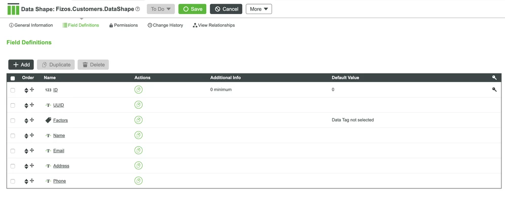

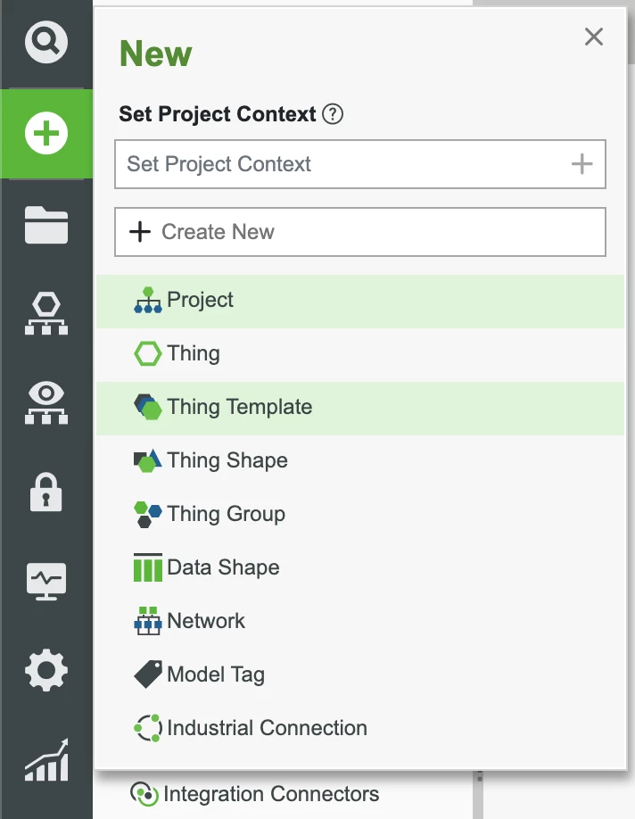

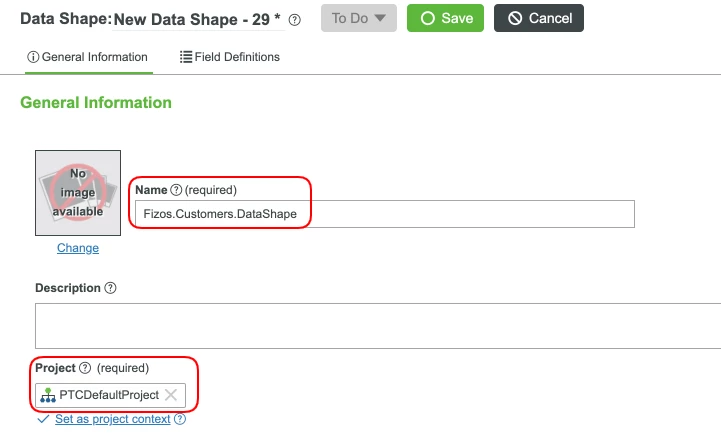

  1. In the ThingWorx Composer, click the + New in the top left of the screen.
  2. Select Data Shape in the dropdown.
  3. In the name field, enter Fizos.Customers.DataShape. All of our customers will be based off this Data Shape.
  4. Set the Project (ie, PTCDefaultProject) and click Save to store all changes.
  5. Click on the Field Definitions tab and click the + Add button to add new Field Definitions.
  6. Add the list of Properties below:
 Name       Base Type      Aspects                           Description
IDInteger0 minimum, primary key, default 0Row identifier
UUIDStringN/AString used as unique identifer across multiple platforms
TypeStringN/AType of customer (individual or another company)
FactorsTagsData TagThis will hold the different type of data points or tags that will help to analyze a customer's characteristics and behavior
NameStringN/ACustomer name
EmailStringN/ACustomer email
AddressStringN/ACustomer address
PhoneStringN/ACustomer phone number
The Properties for the Fizos.Customers.DataShape Data Shape should match the following:

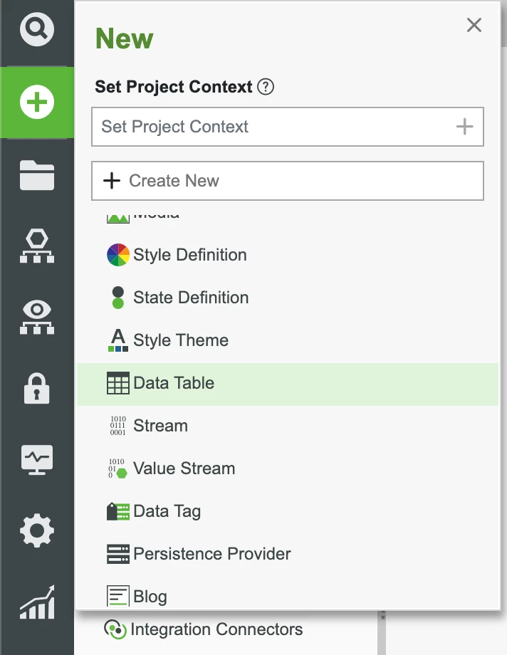

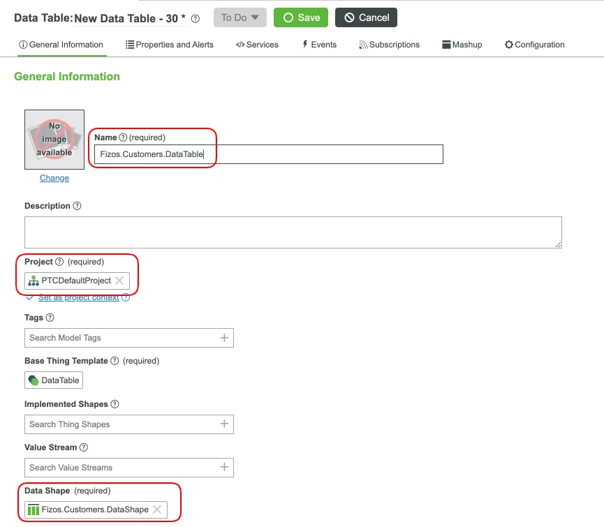

7. In the ThingWorx Composer, click the + New in the top left of the screen.
8. Select Data Table in the dropdown and select Data Table in the prompt.

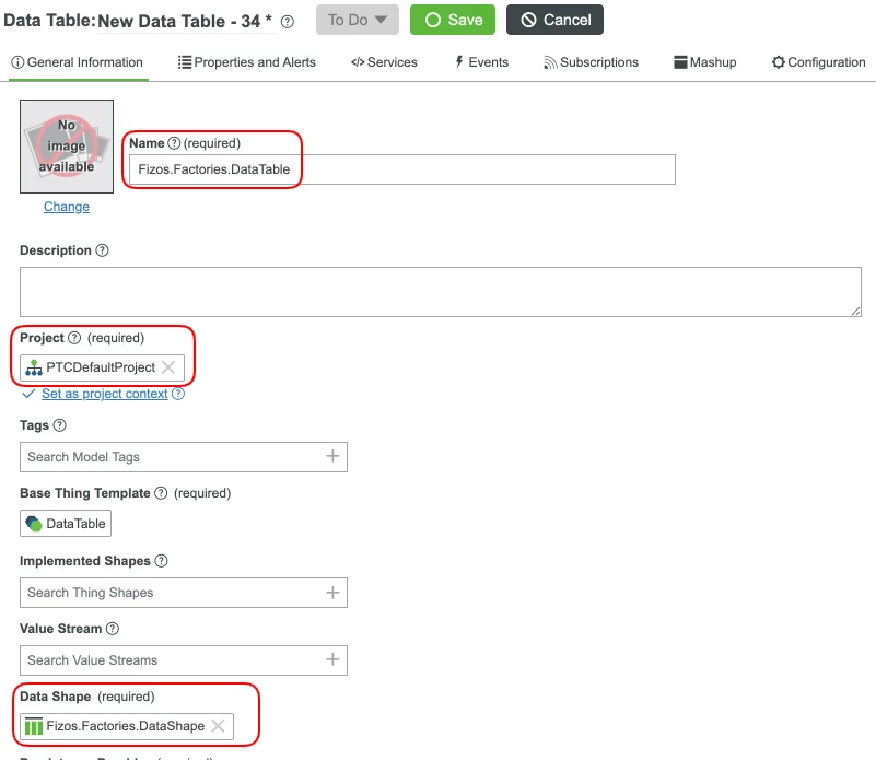

9. In the name field, enter Fizos.Customers.DataTable. Our differing types of customers will fall under this template.
10. For the Data Shape field, select Fizos.Customers.DataShape.
11. Set the Project (ie, PTCDefaultProject) and click Save to store all changes.
12. This entity will be used to house our data and provide assistance with our analytics.

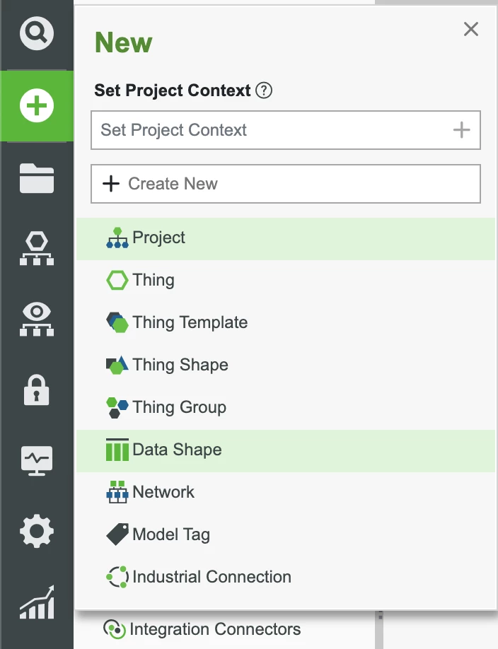

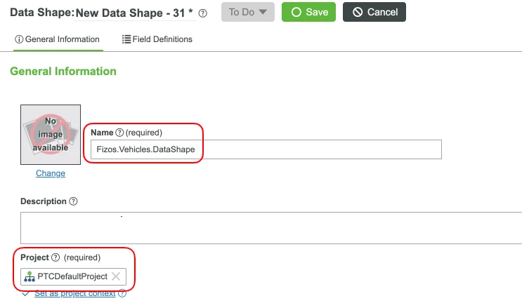

  3. In the name field, enter Fizos.Vehicles.DataShape. All of our vehicles will be based off this Data Shape.

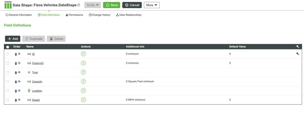

  5. Add the list of properties below:
FactoryIDInteger0 minimum, default 0Factory row identifier
LocationLocationN/AString used as unique identifer across multiple platforms
FeaturesTagsData TagThis will hold the different type of data points or tags that will help to plan what this vehicle can and will build
SizeStringN/AFactory size
The properties for the Fizos.Factories.DataShape Data Shape are as follows:

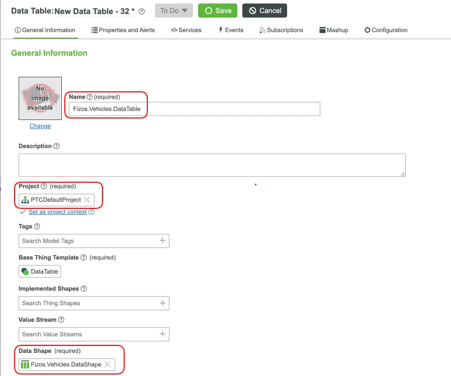

  2. Select Data Table in the dropdown and select Data Table in the prompt.
  3. In the name field, enter Fizos.Vehicles.DataTable. Our differing types of vehicles will be inside of this Data Table.
  4. For the Data Shape field, select Fizos.Vehicles.DataShape.
  5. Set the Project (ie, PTCDefaultProject) and click Save to store all changes.
  6. This entity will be used to house our data and provide assistance with our analytics.

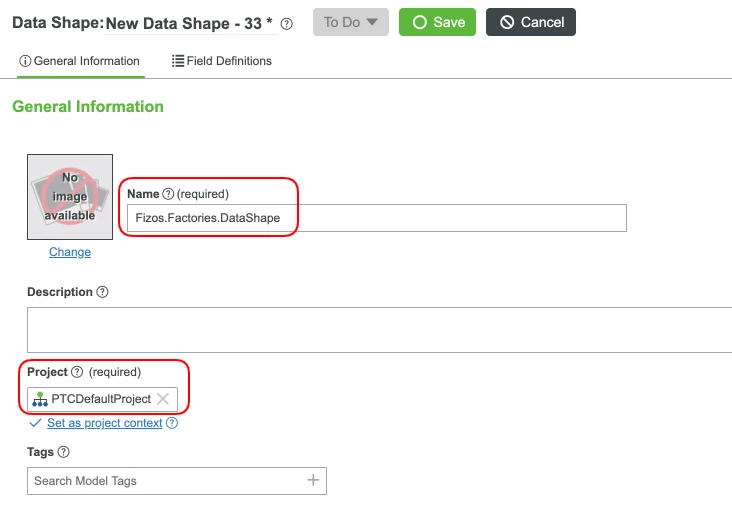

  3. In the name field, enter Fizos.Factories.DataShape. All of our factories will be based off this Data Shape.

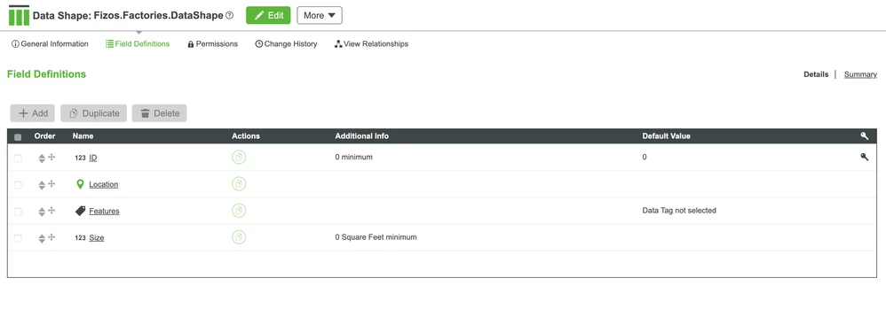

FeaturesTagsData TagThis will hold the different type of data points or tags that will help to plan what this factory can and will build
  2. Select Data Table in the dropdown.
  3. In the name field, enter Fizos.Factories.DataTable. Our differing types of factories will be inside of this Data Table.
  4. For the Data Shape field, select Fizos.Factories.DataShape.

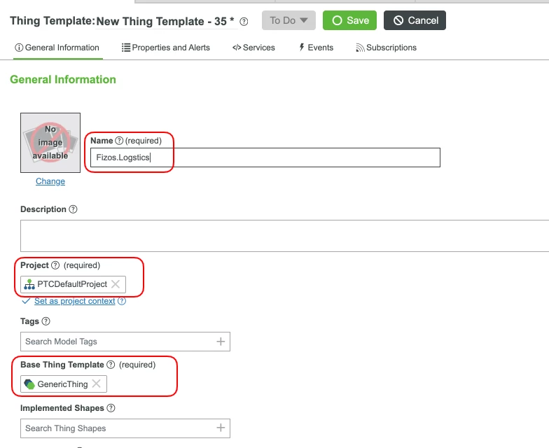

  2. Select Thing Template in the dropdown.
  3. In the name field, enter Fizos.Logstics. All of our product line will fit this abstract entity.
  4. For the Base Thing Template field, select GenericThing.

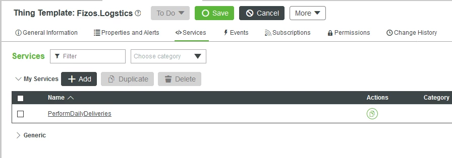

  6. Add the list of Services below. The level of the complexity in these Service vary based on how you would like to start your daily routine, the number of employees, number of deliveries and facilities, etc.
Name                                    Return Type   Override    Async     Description
PerformDailyDeliveriesNothingYesYesStart process of regular product deliveries.
The list of services should look like the following:

I found an error in this document regading the Fizos.Vehicles.DataShape. In fact there is a mismatch between the table with the fileds definition we need to add and the picture.
