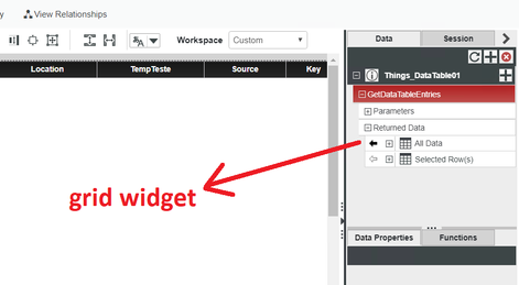

How to display the data table in the mashup and how can the user enter the value for the the columns? Thanks
July 16, 2019
Hello, @nameernazeer!
You can use the grid widget then simply add a GetDataTableEntries service from your new DataTable thing (you do this on the data tab located on the right side). Then bind the desired data to your grid widget.
In the example below I've used "All Data", but you can select specific data to bind to your Grid widget if you want.
