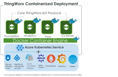

New Resource: Deploying ThingWorx on Kubernetes
As container adoption matures, so does the need for robust orchestration tools. That’s why we’re excited to introduce a new best practices guide for deploying ThingWorx containers on Kubernetes, with a focus on Azure Kubernetes Service (AKS). This guide is designed to help you take the next step in managing your containerized applications at scale, offering information on:
  • Setting up and managing Helm chart repositories.
  • Preparing your Azure environment, including resource groups, virtual networks, and container registries.
  • Creating and managing content repositories for Docker images.
  • Deploying and configuring Azure Kubernetes Service (AKS) clusters.
  • Implementing essential supporting components such as Monitoring Stacks, Certificate Managers, Ingress
  • Controllers, Azure PostgreSQL Databases, and Storage Accounts to facilitate ThingWorx deployment.
  • Detailed steps to deploy ThingWorx in various configurations, including standalone , high availability (HA) , and with eMessage Connector (eMC).
  • Procedures for upgrading ThingWorx deployments
You can access this guide on our GitHub repository: ThingWorx Kubernetes Deployment (twx-k8s). Whether you’re scaling to support thousands of devices or simply looking for more efficient management of your IIoT infrastructure, this guide helps you with the best practices you need to succeed in your containerization efforts for ThingWorx.
