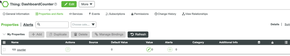

Thing: DashboardCounter, which includes:
  • 1 Property: name:counter, type:integer, logged:true, default value:0

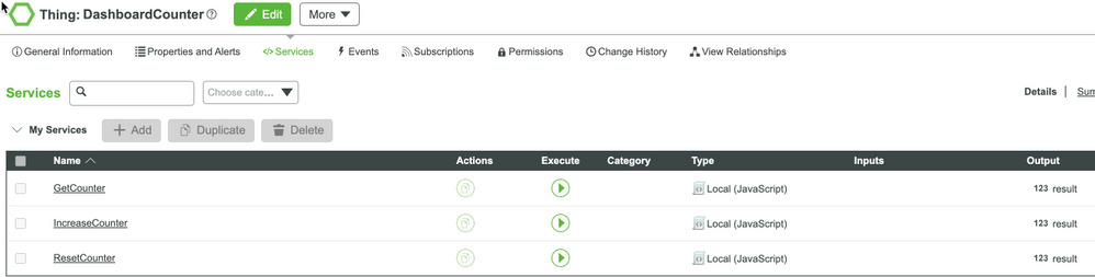

  • 3 services:
    • IncreaseCounter(): increase counter value 1
    • GetCounter(): return current counter value
    • ResetCounter(): set counter value to 0

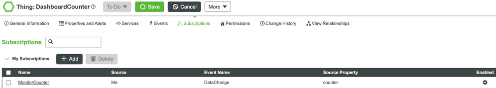

  • 1 Subscription: a subscription to the data change event of the property counter, which will print the new value and timestamp to the log.
GetCounter
var result = me.counter;
IncreaseCounter
me.counter = me.counter + 1;
ResetCounter
me.counter = 0;
var result = 0;
Subscription MonitorCounter
Logger.info(eventData.newValue.value+":"+eventData.newValue.time.getTime());

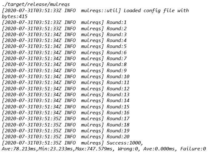

total_round is how many rounds of the test you want to run.
round_size defines how many requests will be sent simultaneously during each round.
round_break is the pause time during each round in Microseconds, so 50000 in the above example means 50ms.
req_break is 0, this is the delay between requests. "0" means requests to the server will happen simultaneously.
The expectation from the above configuration is service execution a total of 20*50 times, 1000 times. So, we can expect that if the initial value is 0, then counter should be 1000 at the end, and if the value stream is clean initially, then the value stream should have a history from 1 to 1000.

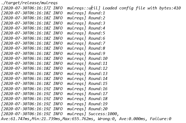

Run Test
Use the following command to perform the test:
.<your path>/mulreqs
Execution output will look like:

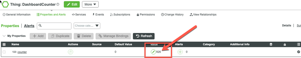

Check Result
You will be surprised that the final value is 926 instead of 1000. (Caution: this value will be different in different tests and it can be any value in the range of 1 and 1000).

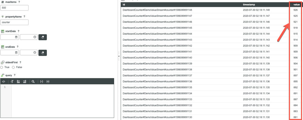

Now, look at the value stream by using QueryPropertyHistory. There are many values missing here, and while the total count can vary in different tests, it is unlikely to be exactly the last value (926). Notice that the last 5 values are: 926, 925, 921, 918. The values 919, 920, 922, and 923 are all missing. So next we check if there are any errors in the script log, and there are none. There are only print statements we deliberately placed in the logs.
So, we have observed two symptoms here:
  1. The final value from property counter doesn't have the expected value.
  2. The value stream doesn't have the expected history of the counter property changes.
What's the reason behind each symptom, and which one is a thread-safe issue?
Understanding Timestamp Granularity
ThingWorx facilitates the collection of time series data and solutions centered around such data by allowing for use of the timestamp as the primary key. However, a timestamp will always have a minimal granularity definition when you process it. In ThingWorx, the minimal granularity or unit of a timestamp is one millisecond.

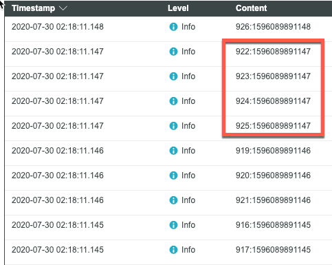

Looking at the log we generated from the subscription again, we see that several data points (922, 923, 924, 925) have the same timestamp (1596089891147), which is GMT Thursday, July 30, 2020, 6:18:11.147 AM. When each of these data points is flushed into the database, the later data points overwrite the earlier ones since they all have the same timestamp. So, data point 922 went into the value stream first, and then was overwritten by data point 923, and then 924, and then 925. The next data point in the value stream is 926, which has a new timestamp (1596089891148), 1ms behind the previous one. Therefore, data points 925 and 926 are stored while 922, 923, 924 are not. These lost data points are therefore NOT a thread-safe issue.
The reason why some of these data points have the same timestamp in this example is because multiple machines write to the same value stream. The right approach is to log data points at the individual machine level, with a different value stream per machine.
However, what happens if one machine emits data too frequently? If data points from the same machine still have a timestamp clash issue, then the signal frequency is too high. The recommended approach would be to down-sample the update frequency, as any frequency higher than 1000Hz will result in unexpected results like these.

The final value of the counter being an arbitrary random number is the real thread-safe coding issue. if we take a look at the code again:
This piece of code can be split into three-piece:
  • Step 1: read current value of me.counter
  • Step 2: increase this value
  • Step 3: set me.counter with new value.
In a multi-threaded environment, not performing the above three steps as a single operation will lead to a race issue. The way to solve this issue is to use a locking mechanism to serialize access to the property, which will acquire the lock, perform the three operations, and then release the lock. This can be done using either the Java Extension or the database thing to leverage the database lock mechanism.

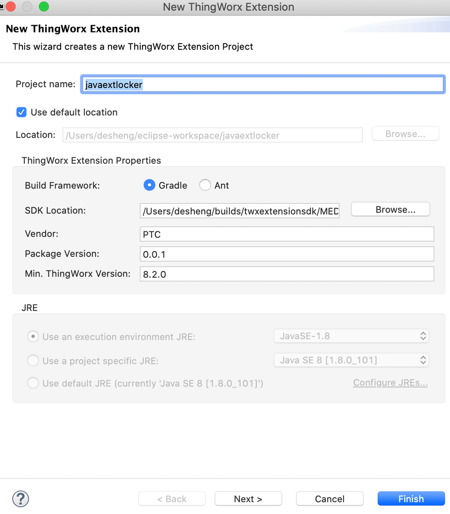

This tutorial assumes that the Eclipse plug-in for ThingWorx extension development is already installed. The following will guide you through creating a simple Java extension step by step:

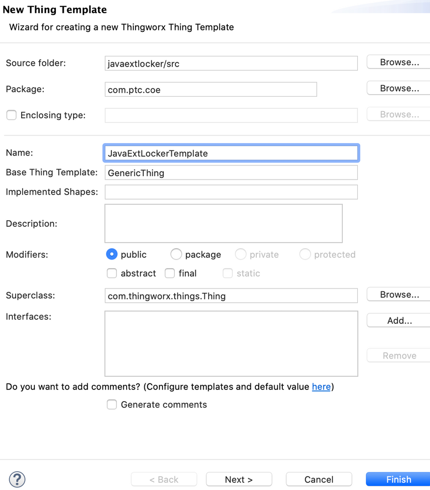

  1. Create a Java Extension ProjectimageChoose the minimal ThingWorx version to support and select the corresponding SDK. Let's name it JavaExtLocker, though it’s best to use lower-case in the project name.
  2. Add a ThingWorx Template in the src Folder
    Right-click the src folder and a a Thing Template.

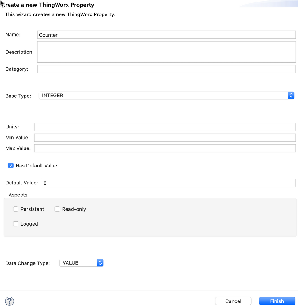

  3. Add a Thing property
    Right click on the Java source file created in the above step and click the menu option called Thingworx Source, then select Add Property.

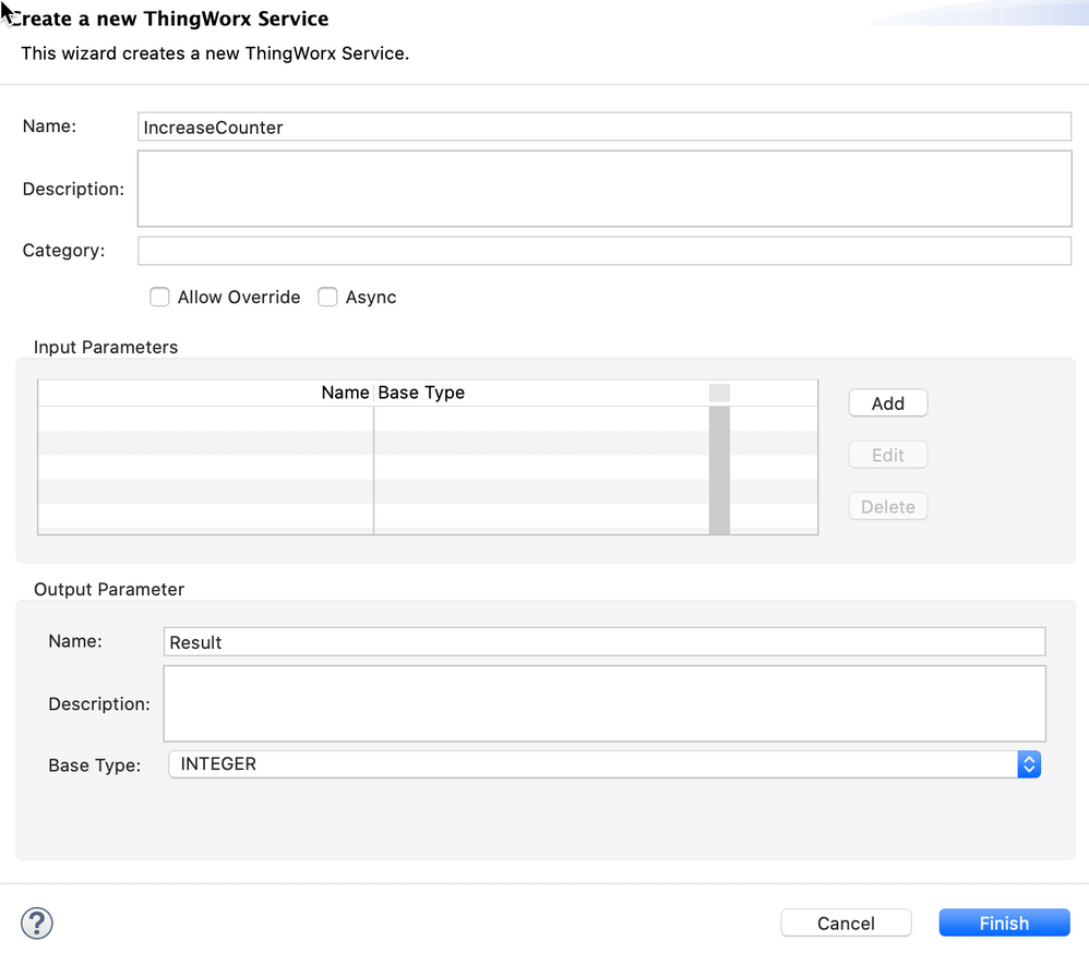

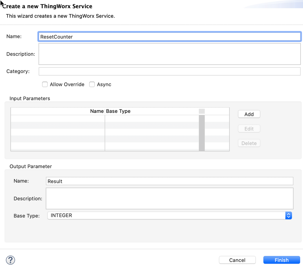

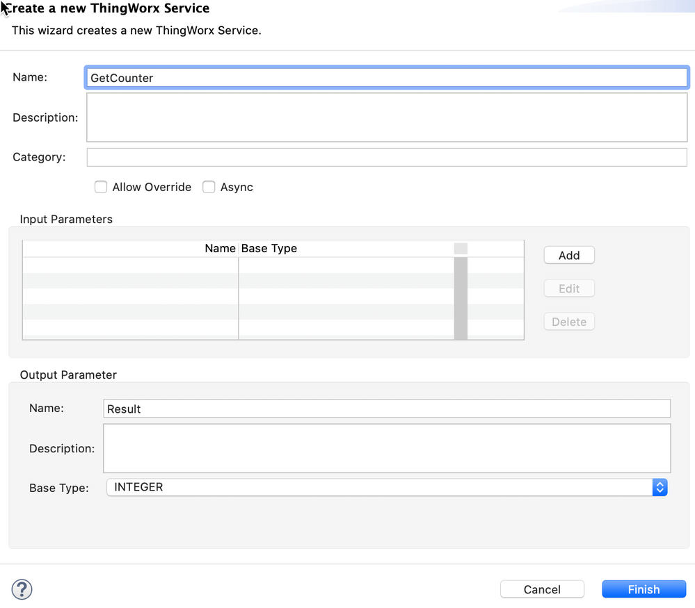

  4. Add Three Services: IncreaseCounter, GetCounter, ResetCounter
    Right click the Java source file and select the menu option called Thingworx source, then select Add Service. See above for the IncreaseCounter service details.
    Repeat these same steps to add GetCounter and ResetCounter:

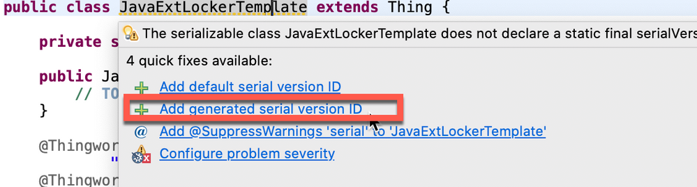

  5. (Optionally) Add a Generated Serial ID

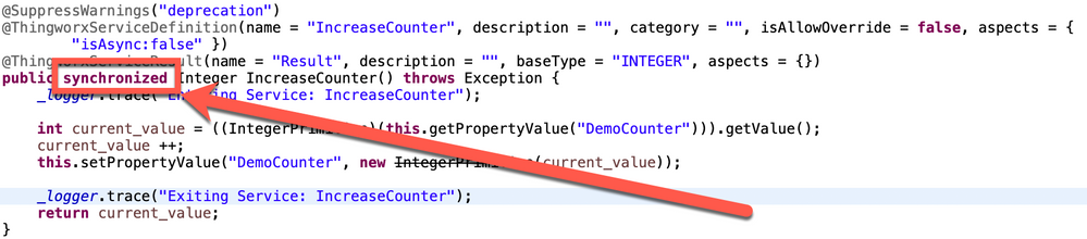

  6. Add Code to the Three Services
    @SuppressWarnings("deprecation")
    @ThingworxServiceDefinition(name = "IncreaseCounter", description = "", category = "", isAllowOverride = false, aspects = {"isAsync:false" })
    @ThingworxServiceResult(name = "Result", description = "", baseType = "INTEGER", aspects = {})
    public synchronized Integer IncreaseCounter() throws Exception {
    	_logger.trace("Entering Service: IncreaseCounter");
    	int current_value = ((IntegerPrimitive (this.getPropertyValue("Counter"))).getValue();
    	current_value ++;
    	this.setPropertyValue("Counter", new IntegerPrimitive(current_value));
    	_logger.trace("Exiting Service: IncreaseCounter");
    	return current_value;
    @ThingworxServiceDefinition(name = "GetCounter", description = "", category = "", isAllowOverride = false, aspects = {"isAsync:false" })
    public synchronized Integer GetCounter() throws Exception {
    	_logger.trace("Entering Service: GetCounter");
    	int current_value = ((IntegerPrimitive)(this.getPropertyValue("Counter"))).getValue();
    	_logger.trace("Exiting Service: GetCounter");
    @ThingworxServiceDefinition(name = "ResetCounter", description = "", category = "", isAllowOverride = false, aspects = {"isAsync:false" })
    public synchronized Integer ResetCounter() throws Exception {
    	_logger.trace("Entering Service: ResetCounter");
    	this.setPropertyValue("Counter", new IntegerPrimitive(0));
    	_logger.trace("Exiting Service: ResetCounter");
    	return 0;
    The key here is the synchronized modifier, which is what allows for Java to control the multi-threading to prevent data loss.

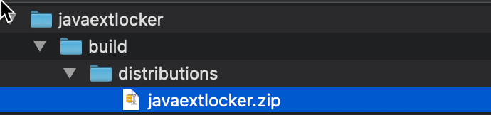

  7. Build the Application
    Use 'gradle build' to generate a build of the extension.

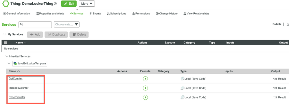

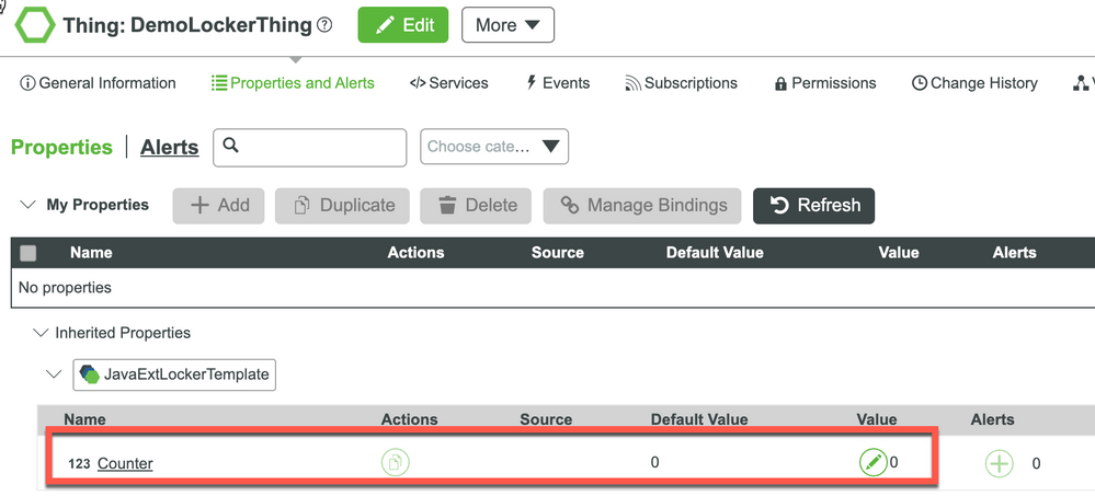

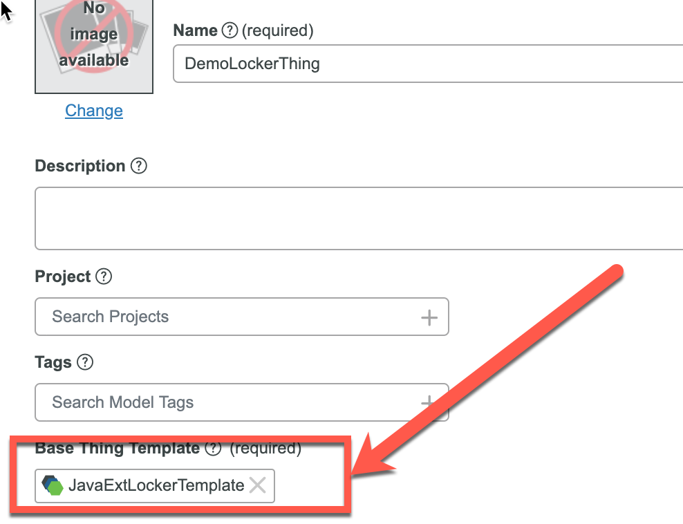

  9. Create Thing Based on New Thing Template
  10. Check the New Thing Property and Service Definition

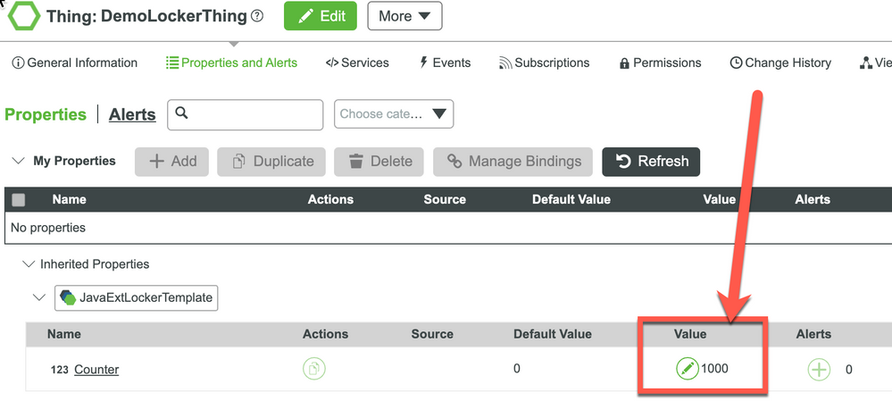

  11. Use the Same Test Tool to Run the Test Again
     "host":"twx85.desheng.io",
     "port":443,
     "protocol":"https",
     	 "endpoint":"/Thingworx/Things/DeoLockerThing/services/IncreaseCounter",
     "headers":{
     "Content-Type":"application/json",
     "Accept": "application/json",
     "AppKey":"5cafe6eb-adba-41df-a7d6-4fc8088125c1"
     "payload":{},
     "round_break":50000,
     "req_break":0,
     "round_size":50,
     "total_round":20
    Just change the endpoint to point to the new thing.
  12.  Check the Test Resultimage
    Repeat the same test several times to ensure the results are consistent and expected (and don't forget to reset the counter between tests).
