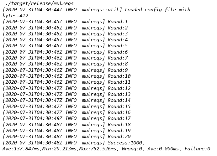

  6. Run the Test Again
    If necessary, head back to the previous post to obtain the tool. Then just change the end point and run a new test:
     "host":"twx85.desheng.io",
     "port":443,
     "protocol":"https",
     "endpoint":"/Thingworx/Things/DatabaseDemo/services/IncreaseCounter",
     "headers":{
     "Content-Type":"application/json",
     "Accept": "application/json",
     "AppKey":"5cafe6eb-adba-41df-a7d6-4fc8088125c1"
     "payload":{},
     "round_break":50000,
     "req_break":0,
     "round_size":50,
     "total_round":20
    Run:

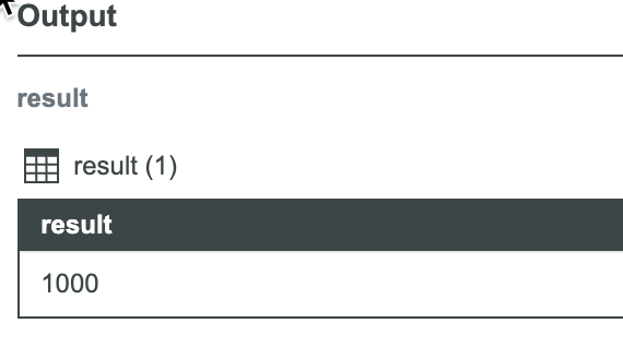

  7. Validate the Result
    Execute the service GetCounter to validate the result:

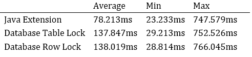

Overall Performance Comparison
The Java Extension performance looks the best here, but the database row lock will perform better if there are multiple counters.
