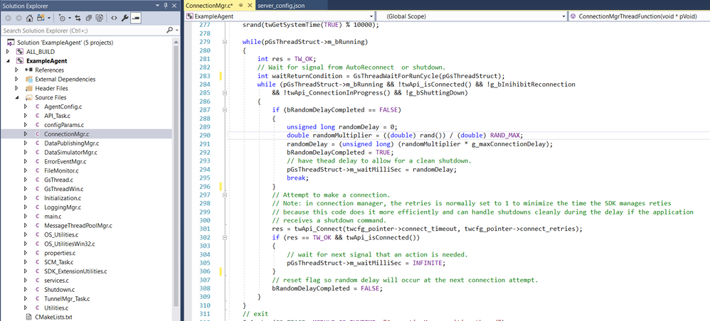

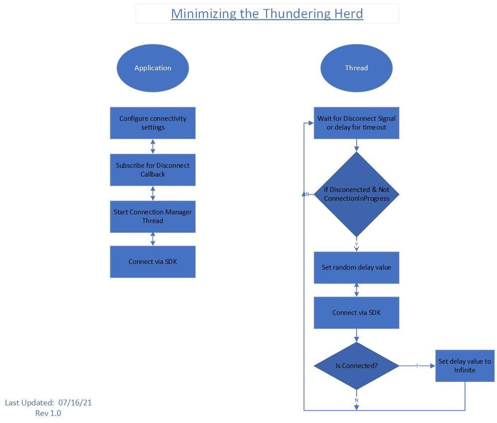

Because of the small downside to configuring the twApi_Connect() function directly as discussed above, there is alternative approach given here as well. The ExampleAgent module ConnectionMgr.c controls the calling of the twApi_Connect() on a dedicated connection thread. The ConnectionMgrThreadFunction() contains the source code necessary to understanding this process.
The ConnectionMgr.c workflow and source code visualization via Microsoft Visual Studio are in the diagrams below.

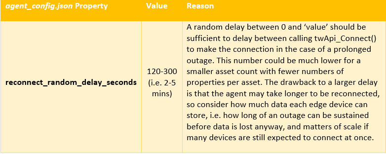

The ExampleAgent defines its own randomized delay to mitigate the thundering herd scenario while still deploying an edge system that responds to shut down requests cleanly. In this case, the randomized delay is configured by the parameter reconnect_random_delay_seconds in the agent_config.json file. Since the ConnectionMgrThreadFunction() controls the calling of twApi_Connect(), the ConnectionMgrThreadFunction() will delay the randomized value EVERY time before calling this reconnect function. A separate thread is created to call the reconnect function so that there are still resources available for data processing and to check for shutdown signals and other conditions.
Recommended Values

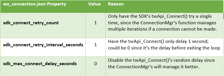

These recommendations are based around managing the reconnection process from the application layer. These may be different if the C-SDK is configured directly, but creating application layer management is recommended and provided in the ExampleAgent attached. The ExampleAgent is configured by default to simplify the SDK layer’s involvement.
These configuration options tell the SDK layer to try to connect just once, after just 1 second:
There is no official recommendation for the above values due to the fact that every use case is different and will require different fine tuning to work well.
Then this setting here handles the retry process from within the application layer of the ExampleAgent:
