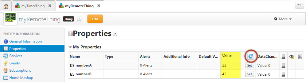

Validation
  • The Subscription will be enabled and active on saving it.
  • Switch to the myRemoteThing Properties
  • Refreshing the Values will show updates with random numbers between 0 and 99 every 5 seconds (Timer Update Rate).
