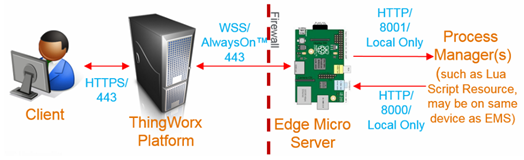

Wanting to build a simple environment with ThingWorx, using a Raspbery Pi mini-computer and an Edge MicroServer (EMS), one has to bear in mind some apparently insignificant tips, that can make a huge difference in a well-connected platform.

The EMS is a pre-built application that can be installed on Windows or Linux and it provides a bridge between the remote device and the ThingWorx platform, using the REST API AlwaysOn protocol.

  • To read data from a sensor, it is important to use the corresponding library for that sensor; if LUA scripting is used, then this library has to be easily integrated with LUA (LSR is optional with EMS; EMS can be used standalone). Using the correct library, the EMS will be able to gather the data and push it to ThingWorx. The LSR sends properties to the EMS over the HTTP(s) protocol, which converts it to the AlwaysOn Protocol, and sends it to the Platform

  • To request a local REST API call to the default EMS port 8000, from a LSR, make sure that the GET works fine (i.e for a property update:
localhost:8000/Thingworx/Things/MyThing/Properties/myString
It should return you something like this:
{"rows":[{"myString":""}],"fieldDefinitions":{"myString":{"name":"myString","description":"","type":"STRING","aspects":{}}}}
