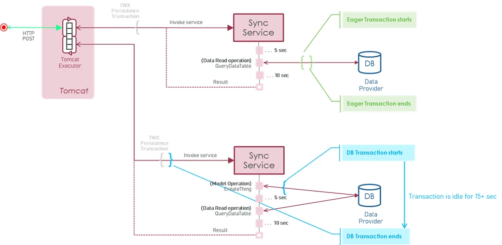

Important change in ThingWorx 9.3.2
  • Since 9.3.2, Transaction behavior depends on the type of database opration:
    1. Model operations which acquire a transaction and hold it until the top-level service finishes - same behavior as pre-9.3.2.
      Once a connection is retrieved for performing model operations, it cannot be released until the service terminates.
    2. Data read operations which have been updated to eagerly release their transaction (Data write operations, such as property writes, are always batched and processed asynchronously from a different thread).
      Performing Data read operations before model operations allows a connection to be retrieved for querying, then released while other work is being completed.
      Sample services with that use Eager Transactions: DataTable, Stream, ValueStream get/find/query/search
The post below is valid for all ThingWorx versions until 9.3.1

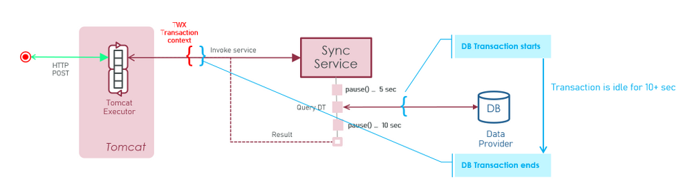

Lets consider a couple of use cases
A. Long running service (the pauses represent for example calls to an external system)
pause(5000); // 5 sec
result = MyDataTable.GetDataTableEntryCount(); // Start DB Transaction
pause(10000); // 10 sec
This service is invoked via REST :
  1. The HTTP request reaches the platform
  2. The platform automatically creates a transaction context
  3. The custom Service is invoked
    1. GetDataTableEntryCount() hits the persistence provider, a DB transaction is started
    2. pause(10000) does not interact with the DB, but the previous transaction remains open (idle)
  4. The DB transaction is closed only after the entire request is complete

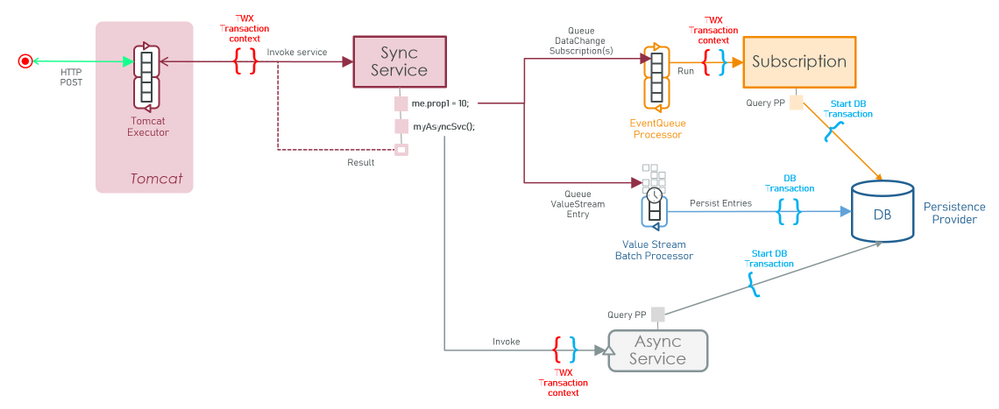

B. Request that involves multiple threads
me.prop1 = 10; // logged property with data change subscription, the subscription queries a Data Table
myAsyncSrc(); // Asynchronous service that also queries a Data Table
  3. The custom Service is invoked:
    1. me.prop1 = 10;
      1. In-memory property update is not atomic nor transactional
      2. A subscription that access the persistence provider is triggered, but it is executed by a different thread and an new transaction context  is created (not nested)
      3. The property value is logged into a value stream, the persistence is performed by an other thread asynchronously
    2. myAsyncSrv()
      1. This asynchronous service is executed by a different thread and an new transaction context is created (not nested)
  4. The request is complete without ever starting a persistence transaction since the service/thread itself did not acquire a database connection
