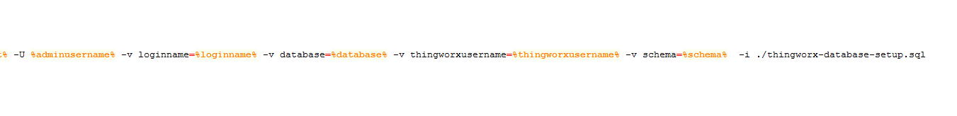

A few things to check here. First, how the database was set up. The standard expected port if 1433, however, if you choose a different port - ensure that the port is available. If it isn't - update the port setting in SQL configuration manager.
Another possible root cause -- the database scripts did not run properly upon the setup. Currently, there is an active Jira PSPT-3587 for resolving the script issue (NOTE, this thread to be updated once the Jira is fixed). There are two options here, either to run the sql files manually (found in the "install" folder of the downloadable), or edit the bat scripts manually. It's recommended to edit the script files instead because running the sql commands allows more room for a mistake.
The following line in the bat scripts needs to be edited to have the ".\" removed:
  1. sqlcmd.exe -S %server%\%serverinstance%,%port% -U %adminusername% -v loginname=%loginname% -v database=%database% -v thingworxusername=%thingworxusername% -v schema=%schema%  -i .\thingworx-database-setup.sql
Note, that the scripts need to be run from the same directory ("/install")
