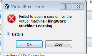

Error Starting Appliance in VirtualBox
Users have experienced this issue at the first run of the Appliance, right after it has been assembled. This issue is unique to VirtualBox versions 5.0 and above.
Error Message – Dialog Box
If you encounter the error depicted below, please check under settings for the imported OVA for any errors:

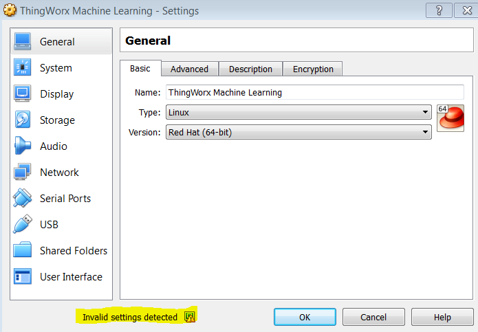

This issue is the result of invalid settings in the Appliance Configuration. You will need to check for Invalid Settings, by navigating to the Settings Menu for the Appliance:
The “Invalid settings detected” indicates that when the Product was assembled, some configuration settings were not applied correctly by the creation tool scripts.

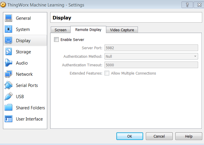

Hover your mouse over the settings and it will direct you to cause, in this case it is due to remote monitor setup. Just change the settings in Display (Remote Display Tab) by unchecking the Enable Server button.
Press OK after unchecking the “Enable Server” option, and start the Appliance.
