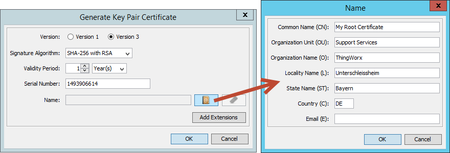

Via Tools > Generate Key Pair create a new key-pair.
Use the RSA algorithm with a key size of 4096. This size is more than sufficient.
Set a validity period of e.g. 302 days.
It's important that all subsequent certificates have a lower validity period than the original signer.
Leave the other defaults and fill out the Name (addressbook icon).
Only the Common Name is required - usually I never use the Email field, as I want to avoid receiving more spam than necessary.
Click OK and enter an alias for the Root CA (leave the default).
A new password needs to be set for the private key part of the certificate.
The new Root CA will now show up in the list of certificates.

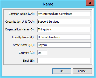

Fill out the Name again - this time as Intermediate Certificate.

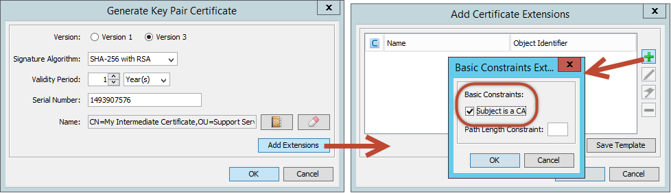

A Intermediate Certificate is a Certification Authority (CA) in itself.
To reflect this, a Basic Constraint must be added via Add Extensions.
Mark the checkbox for Subject is a CA
Confirm with OK, set the alias (or leave the default) and set the password for the private key part.
The new Intermediate CA will now show up in the list of certificates.

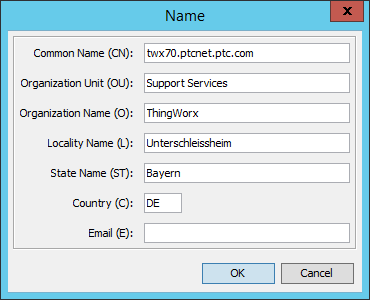

Fill out the Name again - this time it's important to actually use the public servername, so that browsers can match the server identity with its name in the browser's address bar.
If the servername does not match exactly, the certificates and establishing trust will not work!

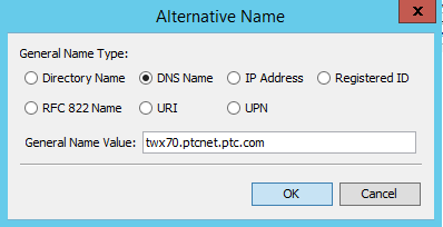

In addition to this, a Subject Alternative Name must be defined - otherwise the latest Chrome versions consider the certificate as invalid.
Click on Add Extensions and the + sign, choose Subject Alternative Name.
Add a new name with the + sign. Make it the same as the Common Name (CN) above.
As before, confirm everything with OK, enter an alias and a password for the private key part.

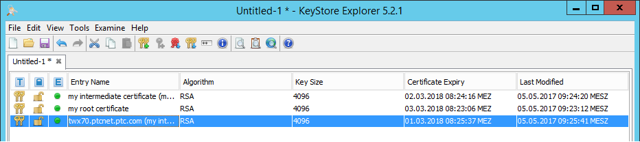

All certificates should now show with their corresponding properties in the certificate list:
Notice the expiry date - the higher up the chain, the sooner the expiry date.
If this is not the case - the certificates and establishing trust will not work!
Save the keystore via File > Save As and set a password - this time for the keystore itself.

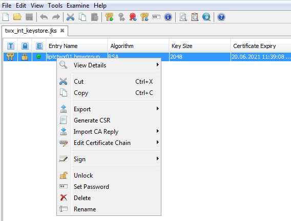

Then I used the Keystore explorer to import the CA reply (right click on the key pair) and copied the keystore via ftp to the server.
Restart tomcat and done.
 Option with keytool: -importcert  https://docs.oracle.com/javase/7/docs/technotes/tools/windows/keytool.html
