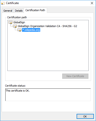

A certificate can be digitally signed to ensure its identity. Usually a Certificate Authority (CA) signs the certificate.
This CA can in turn be signed by another CA and so an, creating a whole chain of CAs. This chain is commonly known as the Chain of Trust or the certification path.

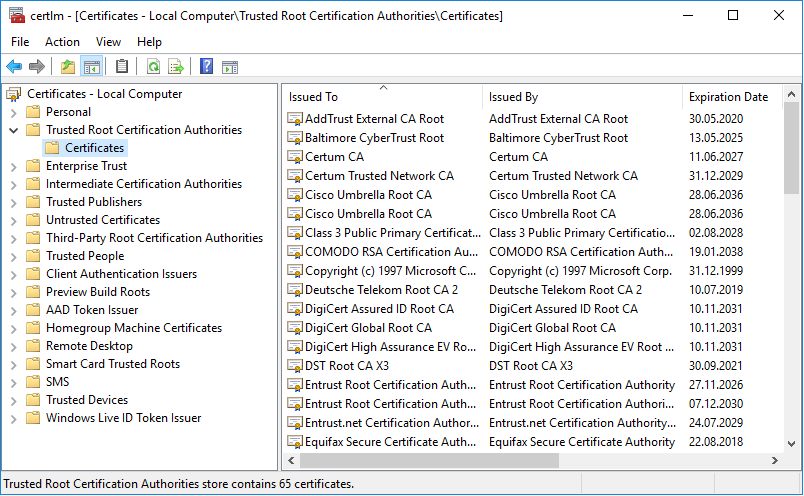

Certificates in Windows
The default Windows-Keystore is actually pre-filled with lots of Root-Certificates, which start the Chain of Trust - such as Google, VeriSign or Microsoft.
Trust needs to start somewhere…
If the browser can trace the CAs of certificate back to a trusted Root CA, it's indicated by a green lock and the server will be trusted.
If the Root CA cannot be found, it's indicated by a red lock (not a purse) - meaning that the server is not trusted.
The server can still be contacted anyway, by manually acknowleding the risks (like identity theft or credit card scams).
As an example, here's the certificate for Wikipedia and its Chain of Trust, starting with the GlobalSign Root CA:
