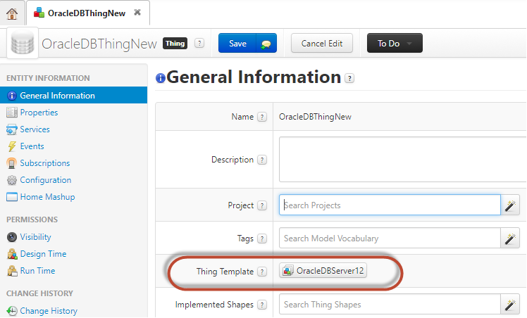

​​Importing the JDBC extensions i.e. the RDBMS and JDBC Extensions, creates a Database Template for that particular database. If you are working with RDBMS extension then Template of corresponding Database will be created with similar name e.g. importing the RDBMS Extension for Oracle 12 will create Template named OracleDBServer12. While importing the JDBC driver using the JDBC extension will create Template name based on the JDBC driver used or a custom name could be given.

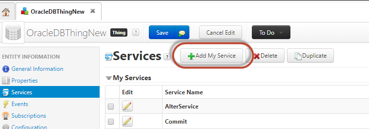

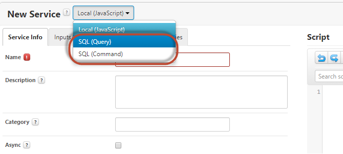

  1. Navigate to the Thing implementing the Database Template, e.g. OracleDBServer12
    2. Click on the Services section under the Entity Information and click on Add My Service
    3. A new service creation section will come up, change the Service type of JavaScript (this is default selection) to either SQL (Query) or SQL (Command) depending on the type of SQL you are to create under this particular service

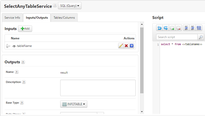

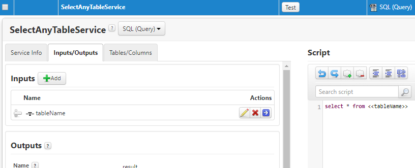

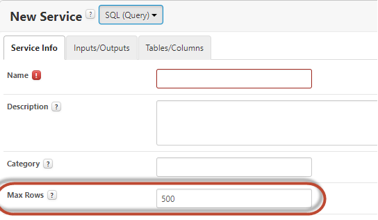

    4. Here's quick example on creating SQL (Query) service which takes name as input for a select *  sql … Statement, i.e. it returns complete set of rows and columns from any given table on which the user has the access to perform Select
    Note: BaseType defaults to Infotable when creating SQL (Query) service and the returned number of rows are restricted to 500. Therefore, if table contains rows more than 500, ensure to change the Max Rows parameters

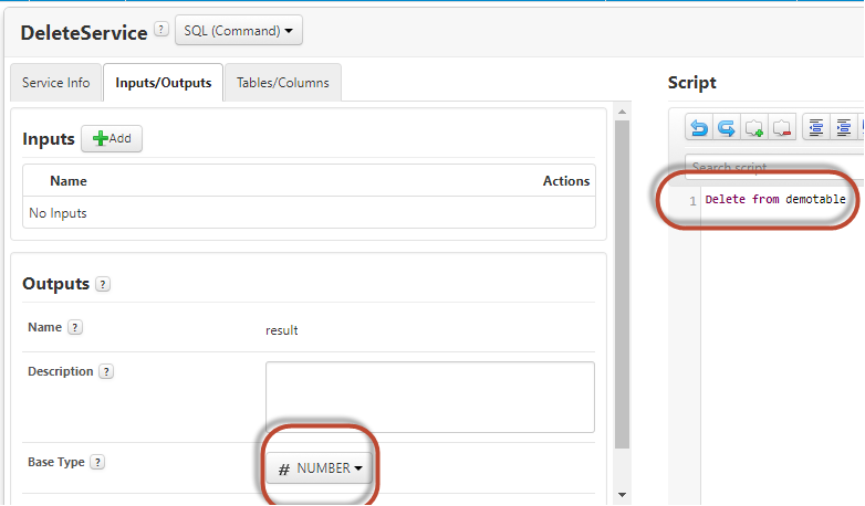

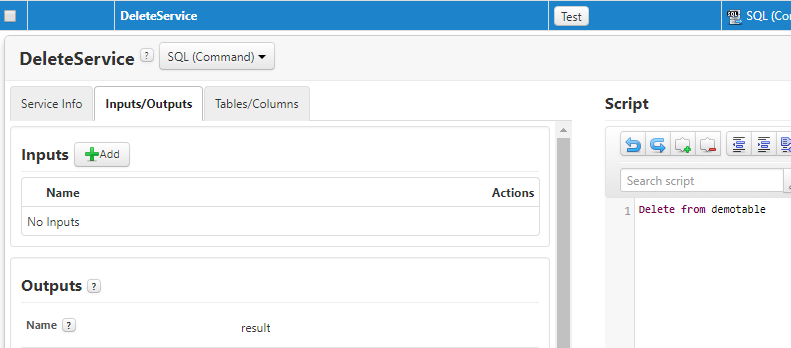

    5. Example on creating SQL (Command) service that delete all the rows from the database table
    Note: The Base Type defaults to Number when using SQL (Command)

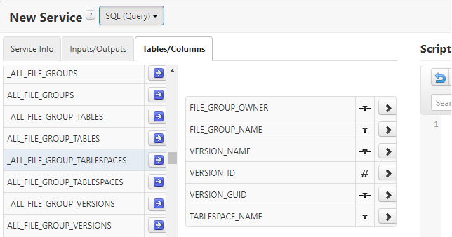

    When creating a SQL service, apart from providing changing the Service Info and  Inputs /Outputs, 3rd section Tables/Columns allows users to explore the Tables and their respective columns as part of that particular user's schema - meaning the objects on which the user has select rights in his schema in the database.

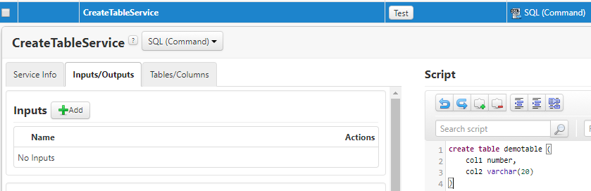

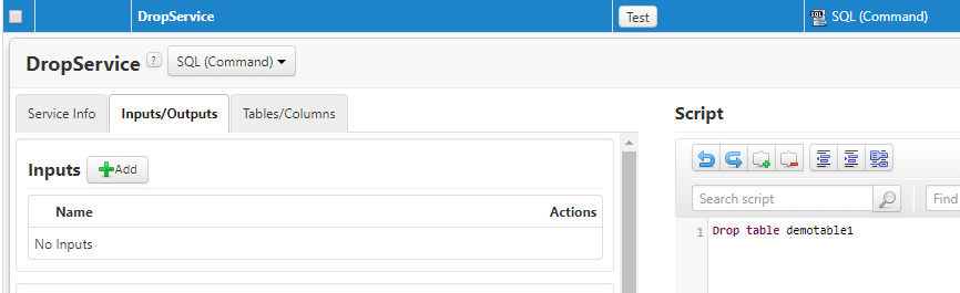

    1. Data Definition Language (DDL)
          a. Create, Alter and drop schema objects
          b. Grant and Revoke privileges and roles
          a. Create statement

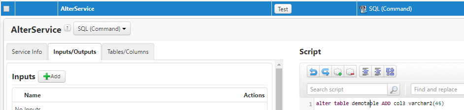

        b. Alter statements
          c. Drop statement

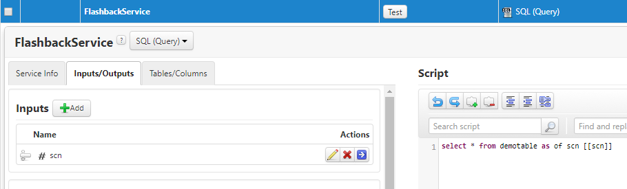

          d. Flashback statements (Oracle specific)

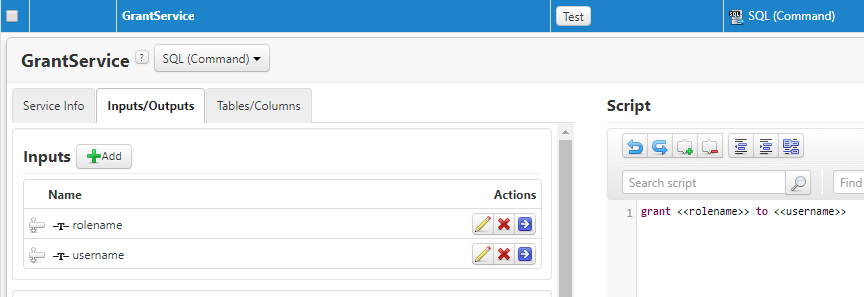

          e. Grant statement

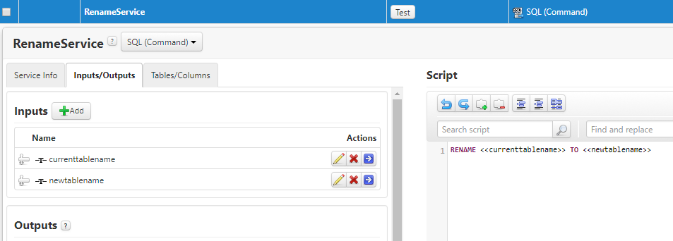

          f. Rename statement

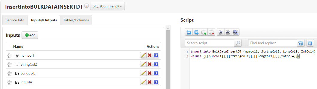

Here's one quick example using one of the Insert SQL service shown above to back up the entire DataTable to the Oracle's DB table.
Following ThingWorx JavaScript service wraps the InsertIntoBULKDATAINSERTDT SQL service:
// result: INTEGER
// getting total row count in the DataTable
var totalCount = Things["BulkInsertDT"].GetDataTableEntryCount();
var params = {
maxItems: totalCount /* NUMBER */
// result: INFOTABLE
// DataTable service to fetch all the rows from it
var allData = Things["BulkInsertDT"].GetDataTableEntries(params);
// looping over the result fetched above to get all the rows for insertion
    for (var i = 0; i<totalCount; i++) {
        var result = allData.getRow(i);
// mapping the data for insert
    var params = {
        LongCol3: result.LongCol3 /* LONG */,
        numcol1: result.NumCol1 /* NUMBER */,
        StringCol2: result.StringCol2 /* STRING */,
        IntCol4: result.IntCol4 /* INTEGER */
try {
// result: NUMBER
// calling the SQL Service InsertIntoBULKDATAINSERTDT created under a DB Thing called OracleDBThingNew
    var result = Things["OracleDBThingNew"].InsertIntoBULKDATAINSERTDT(params);
} catch (err) {
     Logger.info ("Failed to insert the values" + err)
