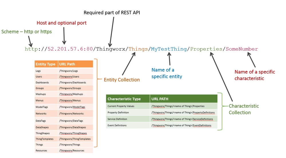

The endpoint URLs used by the REST API follow the consistent pattern shown in the diagram below.
The following table describes the individual pieces of the URL for the REST API calls.

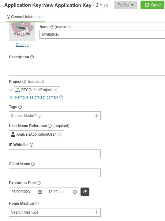

Create an Application Key

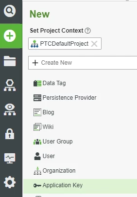

  1. On the Home screen of Composer click + New.
  2. In the dropdown list, click Applications Key.
  3. Give your Application Key a name (ie, MyAppKey).
  4. Set the User Name Reference to a User you created.
  5. Update the Expiration Date field, otherwise it will default to 1 day.
  6. Click Save.
A Key ID has been generated and can be used to make secure connections.

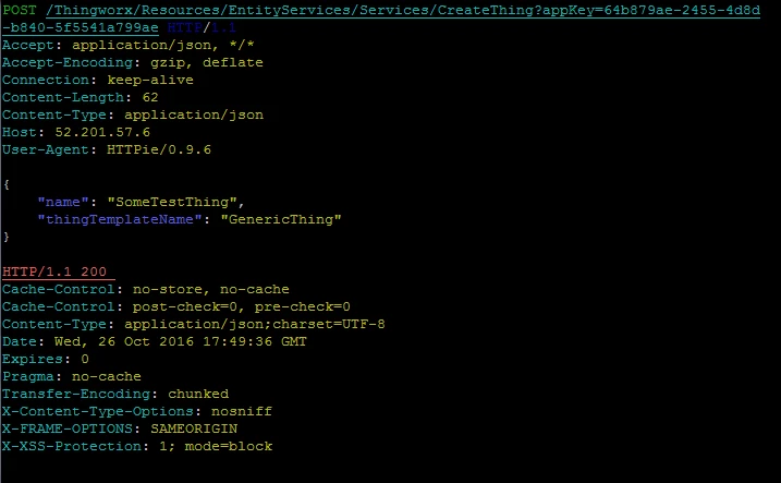

Response
A successful call to the CreateThing service does not return any content in the body of the response, only an HTTP 200 is returned.
Examples
  • HTTPie example:
http -v http://52.201.57.6/Thingworx/Resources/EntityServices/Services/CreateThing appKey==64b879ae-2455-4d8d-b840-5f5541a799ae name=SomeTestThing thingTemplateName=GenericThing
The Content-Type header does not appear in the sample HTTPie call because HTTPie sets the Accept and Content-type request headers to application/json by default.

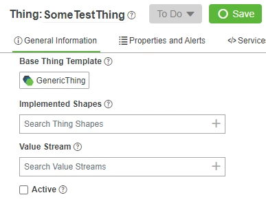

The Thing you just created is now available in the ThingWorx Composer, however before anything else can be done with your new Thing through the REST API it must be enabled and started. Follow these steps to validate that the new Thing has been created and enabled.
  1. From the home page of Composer, click Things, select the name of the Thing you just created, then click General Information.
    NOTE: You will see the Active checkbox is not checked indicating this Thing is not Enabled.

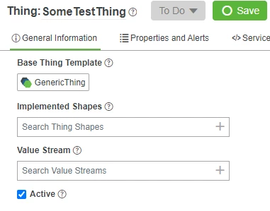

        3.  Confirm new Thing is Enabled.
  • To update the General Information section of your new Thing and confirm the Active checkbox is now checked, refresh the page with the browser or close and re-open your Thing.
