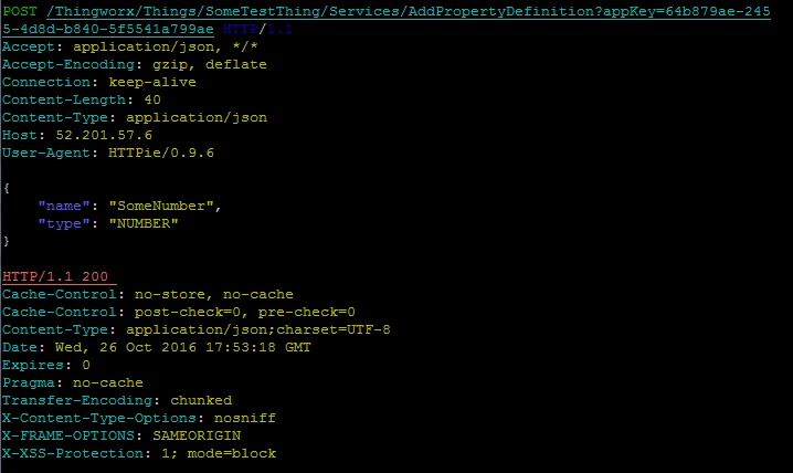

  1. Construct the URL.
  • A new Property can be added to an existing Thing by making an HTTP POST to this endpoint. Substitute <name of Thing> with the actual name of a Thing that exists on the ThingWorx server that will have the Property added.
<server_ip:port>/Thingworx/Things/<name of Thing>/Services/AddPropertyDefinition
    2. Send request parameters.
  • The name of the new Property to be added and type of the Property are sent in the body of the POST as a JSON object. For example, the JSON object below will create a new Property named SomeNumber using the ThingWorx base type NUMBER. Some other commonly used types are STRING, INTEGER, and BOOLEAN.
"name" : "SomeNumber",
"type" : "NUMBER"
NOTE: The full request must include a header with the appKey for your specific ThingWorx server.
Response
A successful call to the AddPropertyDefinitionservice does not return any content in the body of the response. Only an HTTP 200 is returned.
HTTPie example:
http -v -j http://52.201.57.6/Thingworx/Things/SomeTestThing/Services/AddPropertyDefinition appKey==64b879ae-2455-4d8d-b840-5f5541a799ae name=SomeNumber type=NUMBER
WARNING for other HTTP clients: Most HTTP clients do not set a Content-Type header by default, without this header set the server will return an error message. The POST request to the AddPropertyDefinition endpoint has a JSON body so the header must be set to match the format of the request body.
The Content-Type header does not appear in the sample HTTPie call because HTTPie sets the Accept and Content-type request headers to application/json by default. Below is an example cURL call that explicitly sets the Content-Type header to application/json.
curl -v -H "Content-Type: application/json" -X POST -d '{"name": "SomeNumber","type": "NUMBER"}' http://52.201.57.6/Thingworx/Things/SomeTestThing/Services/AddPropertyDefinition?appKey=d0a68eff-2cb4-4327-81ea-7e71e26b

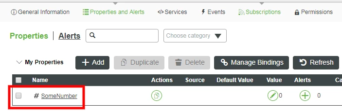

  1. View new Property on Server.
  • The Property you just added is now available in the ThingWorx Composer. Before anything else can be done with your new Property through the REST API, the Thing must be restarted. To confirm your Property was added to your Thing, open Composer and click Things, select the name of the Thing you just created, then click Properties and Alerts. You will see the new Property listed. You may need to refresh to see the changes.

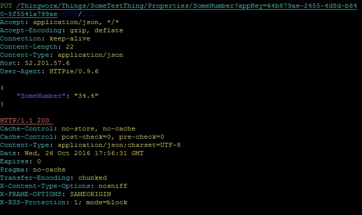

  • A Property value can be set by making an HTTP PUT call to this endpoint:
<server_ip:port>/Thingworx/Things/<name of Thing>/Properties/<name of Property>
  • Substitute <name of Thing> with the actual name of a Thing that exists on the ThingWorx server and <name of Property> with the name of a Property that has been added to the Thing.
  • The name of the Property to be set is duplicated in the body of the PUT and is sent along with the value as a JSON object. The example below will set the Property SomeNumber to 34.4
 "SomeNumber" : 34.4
NOTE: The full request must include authentication credentials for your specific ThingWorx server.
Response
A successful call to set a Property does not return any content in the body of the response. Only an HTTP 200 is returned.
HTTPie example
http -v -j PUT http://52.201.57.6/Thingworx/Things/SomeTestThing/Properties/SomeNumber appKey==64b879ae-2455-4d8d-b840-5f5541a799ae SomeNumber=34.4
WARNING for other HTTP clients: By default HTTPie sets the Accept and Content-type request headers to application/json. A PUT request to the Properties endpoint has a JSON body so the Content-Type header must be set to match the format of the request body.
Most HTTP clients do not set the correct header by default and it must be set explicitly. Below is an example cURL call that sets the Content-Type header to application/json
curl -v -H "Content-Type: application/json" -X PUT -d '{"SomeNumber":12.34}' http://52.201.57.6/Thingworx/Things/SomeTestThing/Properties/SomeNumber?appKey=d0a68eff-2cb4-4327-81ea-7e71e26b

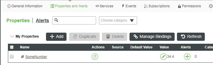

To confirm your Property was changed for your Thing, go to Composer and click Things. Select the name of the Thing you just created, then click Properties and Alerts tab. Click on the circular arrow Refresh to see the updated Property value.

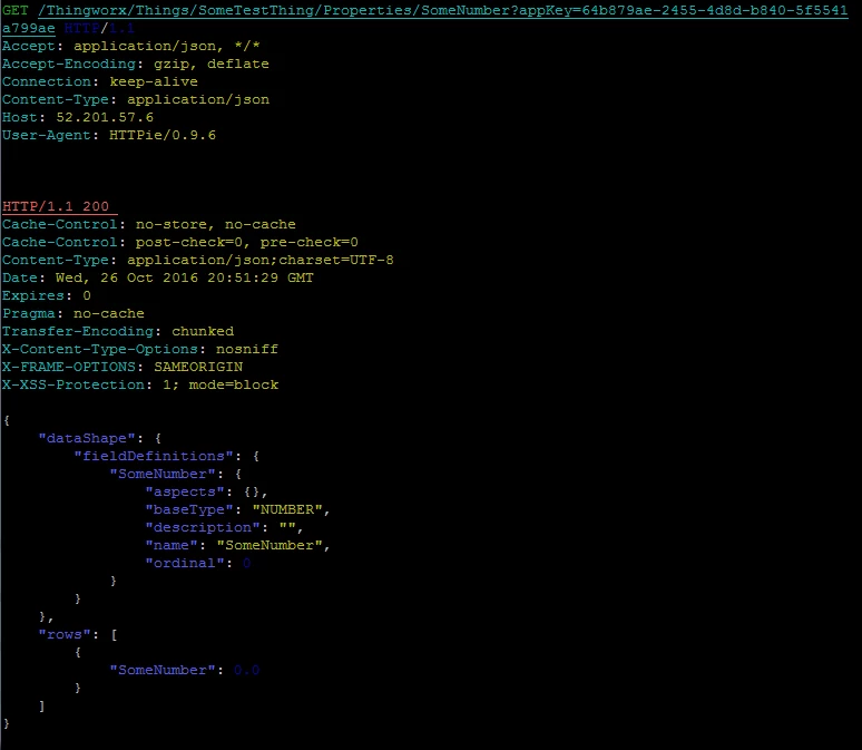

  • To get the current value for a property, make a GET request to this endpoint:
<server_ip:port>/Thingworx/Things/<name of Thing>/Properties/<name of property>
Substitute <name of thing> with the actual name of a Thing that exists on the ThingWorx server and <name of Property> with the name of a Property that has been added to the Thing.
NOTE: The full request will also need to include the hostname and authentication credentials for your specific ThingWorx server.
      2. Send request parameters. Other than authentication, no other parameters are used in  this GET request.
Response
The content can be returned in four different formats by sending an Accept header with the request.
Desired Response Type Accept Header Values
JSON application/json
XML text/xml
HTML text/html (or omit Accept Header)
CSV text/csv
HTTPie example:
http -v -j http://52.201.57.6/Thingworx/Things/SomeTestThing/Properties/SomeNumber appKey==64b879ae-2455-4d8d-b840-5f5541a799ae
