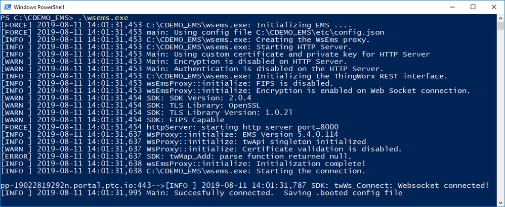

The Web Socket Edge MicroServer (WSEMS... or just EMS for short) is a pre-compiled application based on the C SDK.
Typically, the EMS is used on devices "smart" enough to have their own operating system, such as a Raspberry Pi or personal computer.
Rather than editing code and compiling into a custom binary (as with the SDKs), the EMS allows you to simply edit some configuration files to point the Edge IoT device towards the appropriate ThingWorx Foundation instance.
In addition, the EMS utilizes the PTC-proprietary AlwaysOn protocol to "phone-home", rather than having Foundation reach out to it. As such, the EMS will typically not require port forwarding/opening, and can easily communicate from a more-secure Edge environment to the Foundation server.

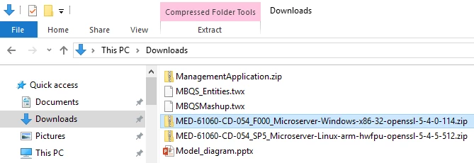

  1. Download the EMS.
  2. Navigate to the directory where you downloaded the .zip file.

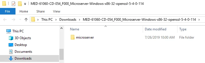

  3. Extract the .zip file and explore into the extracted folder.

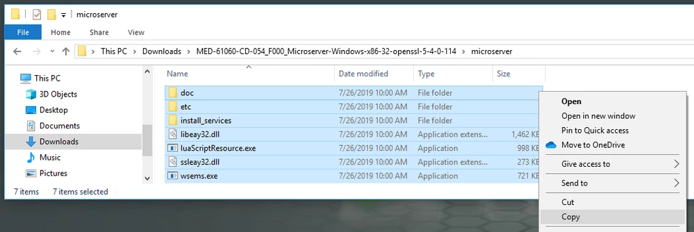

  4. Navigate into and Copy all contents inside the \microserver directory.

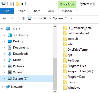

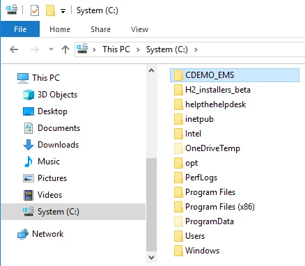

  5. Navigate to the C:\ root directory.

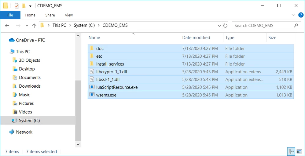

  6. Create a C:\CDEMO_EMS folder.
    • Note that this directory is not mandatory, but will be used throughout the rest of this guide.

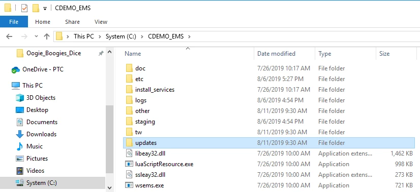

  7. Paste the contents of the extracted \microserver directory into C:\CDEMO_EMS.
Create Additional Directories
New folders may be added to the \CDEMO_EMS directory for various purposes.
Some of these will be utilized within this guide, while others may be utilized in future guides using the EMS.
Note that these particular names are not mandatory, and are simply the names used within this guide.
  1. Create a C:\CDEMO_EMS\other directory.
  2. Create a C:\CDEMO_EMS\tw directory.
  3. Create a C:\CDEMO_EMS\updates directory.

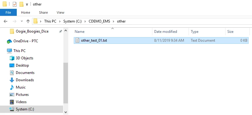

Create Test Files
It can also be helpful during testing to have some small files in these folders to further demonstrate connectivity.
As these files were custom-created for the guide, seeing them within ThingWorx Foundation ensures that the connection between Foundation and the EMS is real and current.
  1. In the C:\CDEMO_EMS\tw directory, create a text file named tw_test_01.txt.
  2. In the C:\CDEMO_EMS\other directory, create a text file named other_test_01.txt.
